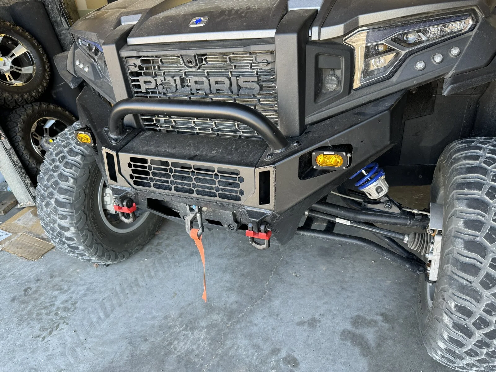

That is a perfect look for those driving lights. This post is great. I am setting up my lights on the bumper. This really simplifies my wiring ideas

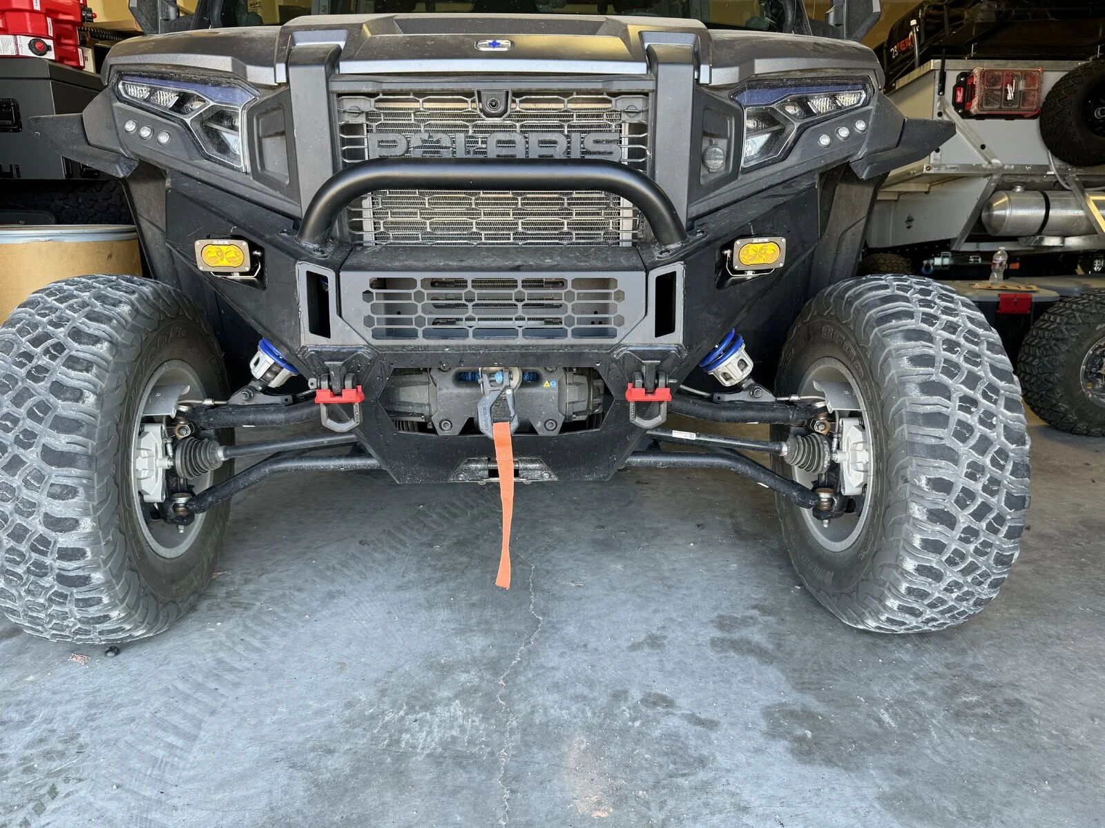

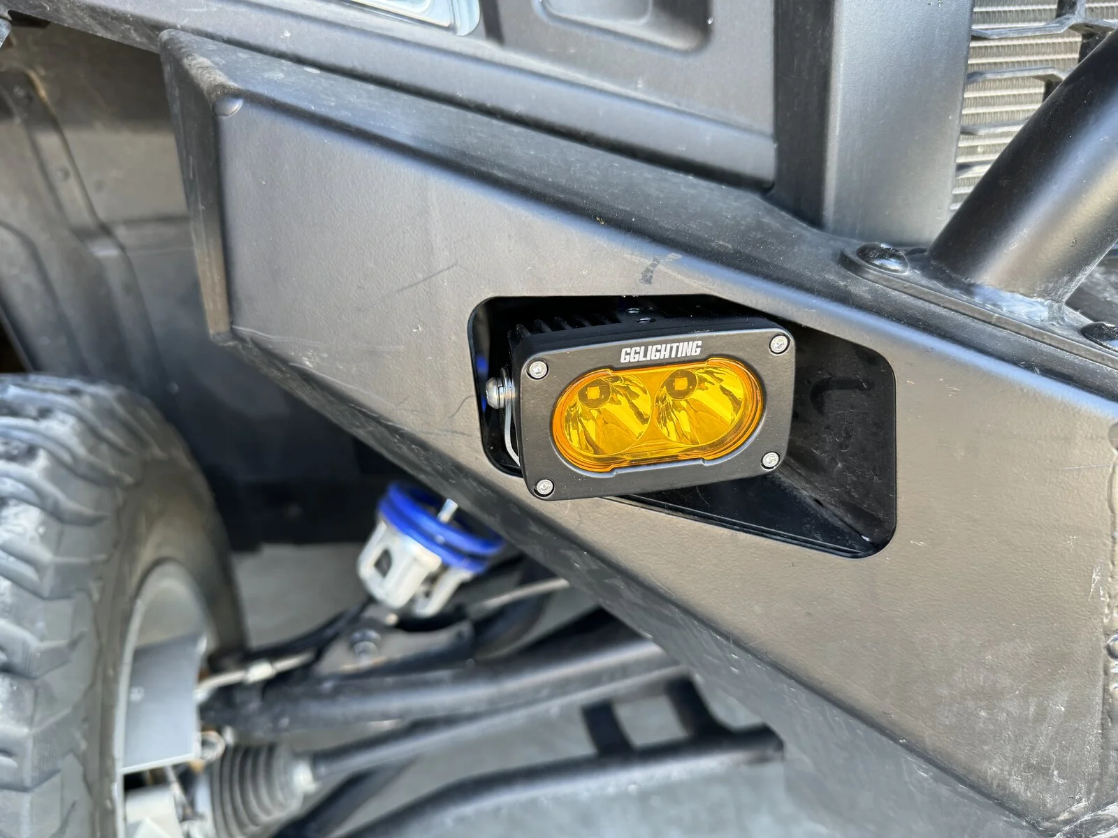

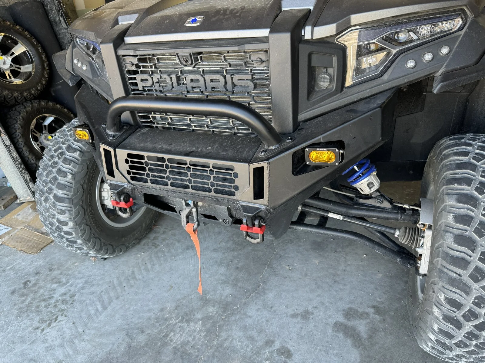

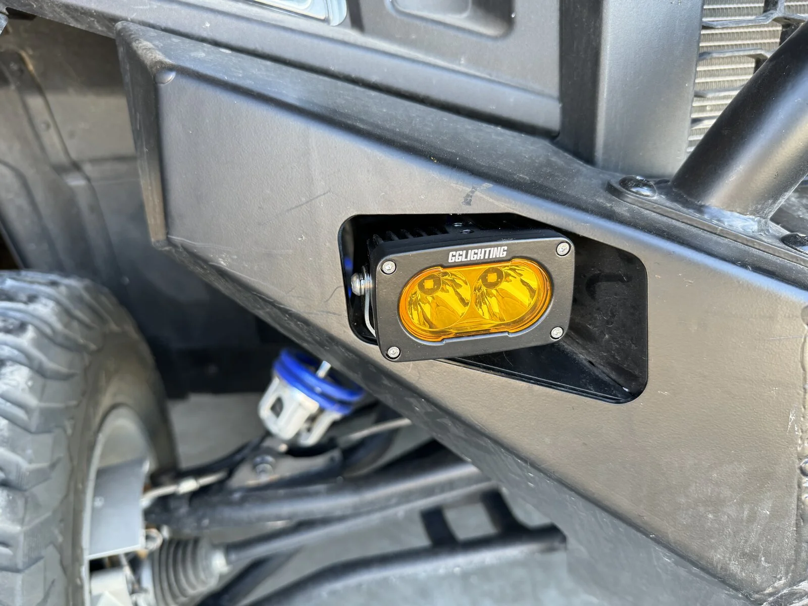

Do you have the part number for that Y cable? ThanksThere was one with a cap but hanging loose on the driver side that had the power from the switch. I didn’t see any uncapped on mine. Also I just bought the Y cable from Polaris to connect the 2 lights. I bought a pair of gp10s from GG Lighting for my driving lights. They don’t fit completely into the hole on the HD bumper but still work good. And they come with deutsch connections. View attachment 1045View attachment 1046View attachment 1047

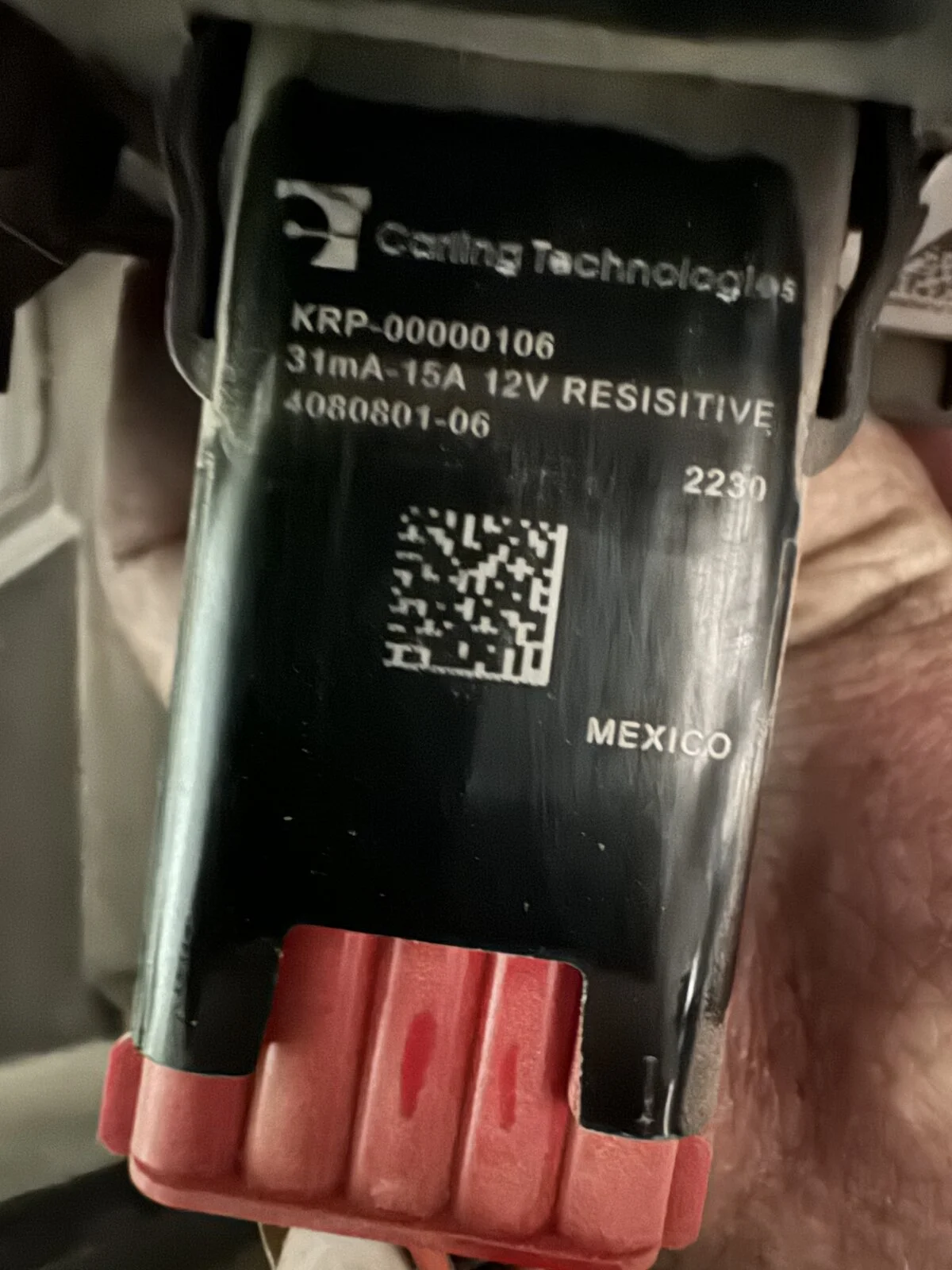

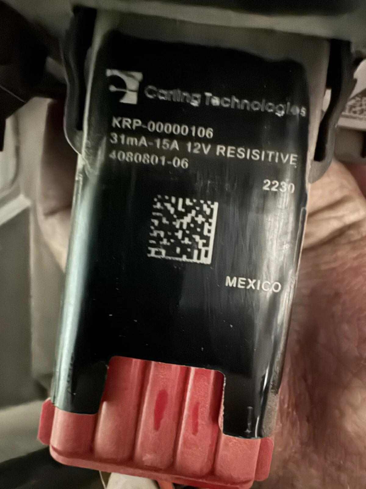

Can you tell me the part number for the rocker switch from Polaris? Any issues with it? ThanksI wasn’t able to find anyone with the rockers for the smaller blade switches. Had to buy the $65 one from Polaris for my auxiliary lights that are pre-wired. I spent quite a lot of time searching the interwebs for one but couldn’t find any![]()
2879860Do you have the part number for that Y cable? Thanks
Thanks!!View attachment 1346
This is all the switch had on it. I don’t have the invoice anymore to see what Polaris part #
Other than the fact that it’s really expensive and proprietary for Polaris, the switch is good and matches the factory switches.
Thanks!2879860
Awesome. Thanks for your help!SWITCH-KSERIES,AUX LIGHT, Part 4080801-06 | Polaris RANGER
SWITCH-KSERIES,AUX LIGHT, Part 4080801-06, and all other service parts deliver unmatched performance and fit for your vehicle. Each one is extensively tested in the .www.polaris.com
I think this is it.
Thanks for your info. I just ordered a set of the sidewinder pods from GG Lighting. They stated they are a 3 pin Deutsch connector. Were your pods 2 or 3 pin? Just trying to figure out the connection and if these will work or not. ThanksThere was one with a cap but hanging loose on the driver side that had the power from the switch. I didn’t see any uncapped on mine. Also I just bought the Y cable from Polaris to connect the 2 lights. I bought a pair of gp10s from GG Lighting for my driving lights. They don’t fit completely into the hole on the HD bumper but still work good. And they come with deutsch connections. View attachment 1045View attachment 1046View attachment 1047
Mine were 2 pin but single function. I believe the gg sidewinders are dual function. White and amber. GG does full wiring though so your lights should come complete with wiring harness, relay and switchThanks for your info. I just ordered a set of the sidewinder pods from GG Lighting. They stated they are a 3 pin Deutsch connector. Were your pods 2 or 3 pin? Just trying to figure out the connection and if these will work or not. Thanks
I called and they were super nice. Explained the XPedition is a 2 pin and they said they would make an adapter to work. We’ll see. Hopefully it works. Ordered the rocker and Y harness adapter from Polaris. Thanks again for the help.Mine were 2 pin but single function. I believe the gg sidewinders are dual function. White and amber. GG does full wiring though so your lights should come complete with wiring harness, relay and switch
They really are great to work with. I’ve been buying from them for about 5 years now. Never had issues with them or their lights.I called and they were super nice. Explained the XPedition is a 2 pin and they said they would make an adapter to work. We’ll see. Hopefully it works. Ordered the rocker and Y harness adapter from Polaris. Thanks again for the help.

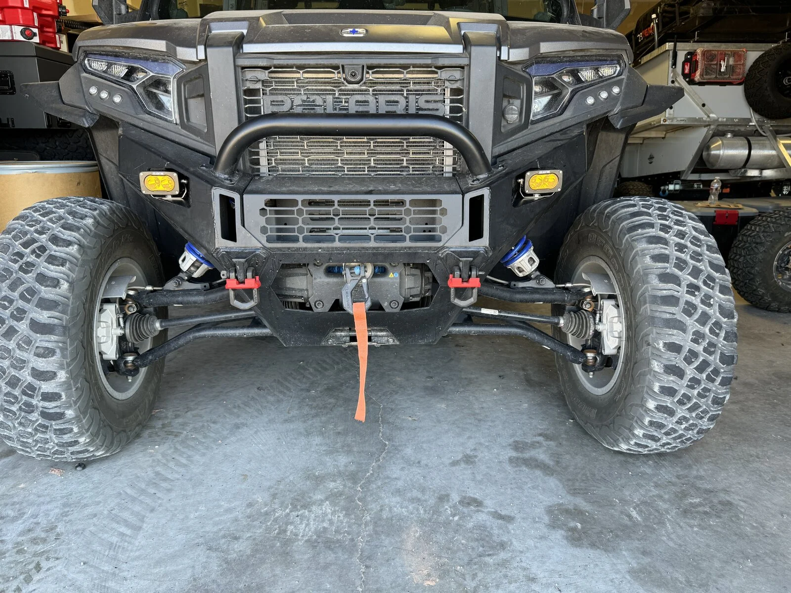

Hey JT, do you recall the part number of the Y cable your purchased? Also, did it plug into the open connector on the xpedition?There was one with a cap but hanging loose on the driver side that had the power from the switch. I didn’t see any uncapped on mine. Also I just bought the Y cable from Polaris to connect the 2 lights. I bought a pair of gp10s from GG Lighting for my driving lights. They don’t fit completely into the hole on the HD bumper but still work good. And they come with deutsch connections. View attachment 1045View attachment 1046View attachment 1047
Part #2879860Hey JT, do you recall the part number of the Y cable your purchased? Also, did it plug into the open connector on the xpedition?
Perfect, thank you sir..Part #2879860
And yes. It plugs into the one by the radiator and splits it.

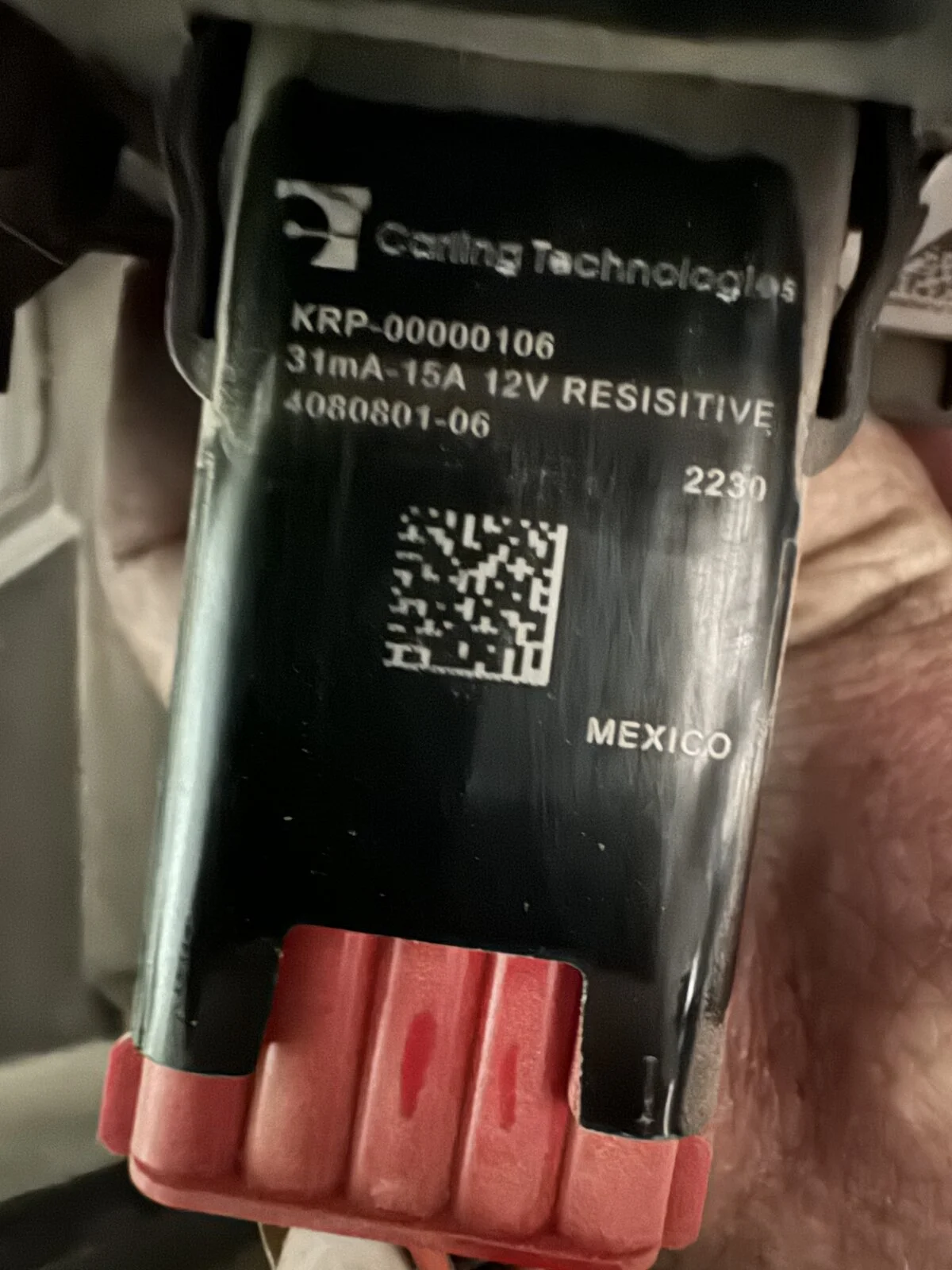

So can these switches be purchased from Carling directly?Hey All, I did some some research on the new (proprietary K-Series) Polaris switches from Carling.
Here are the Polaris Part numbers:
Headlight Switch 4080801-01
AWD /Turf Switch 4080801-02
AWD Switch 4080801-03
Front Bumper Light Switch 4080801-06
Hazard Switch 4080801-08
Horn Switch 4080801–09
Wash/Wiper Switch 4080801-10
Winch Switch 4080801-13
Scene Light Switch 4080801-22
Box Lift Switch 4080801-24
Rear Roof Light Switch 4080801–25
Rear AUX Switch 4080801-26
Driver Modes Switch 4080801-27
Box Light, 3P Switch 4080801-29
