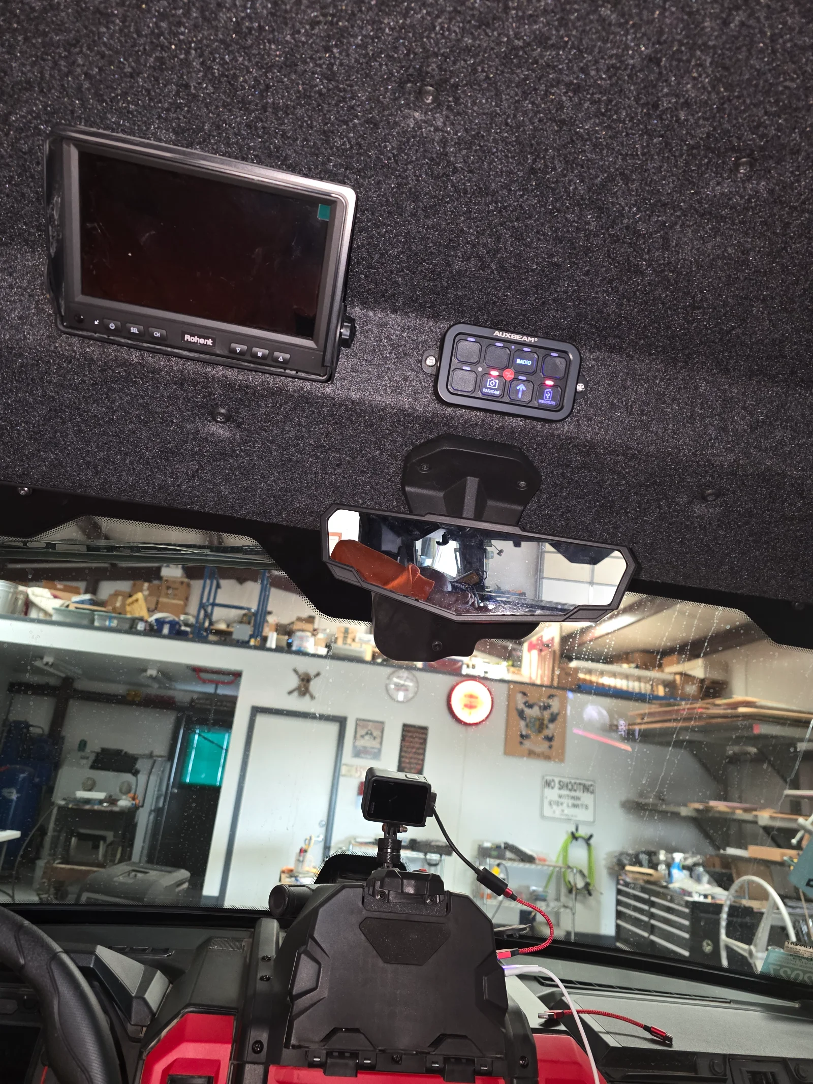

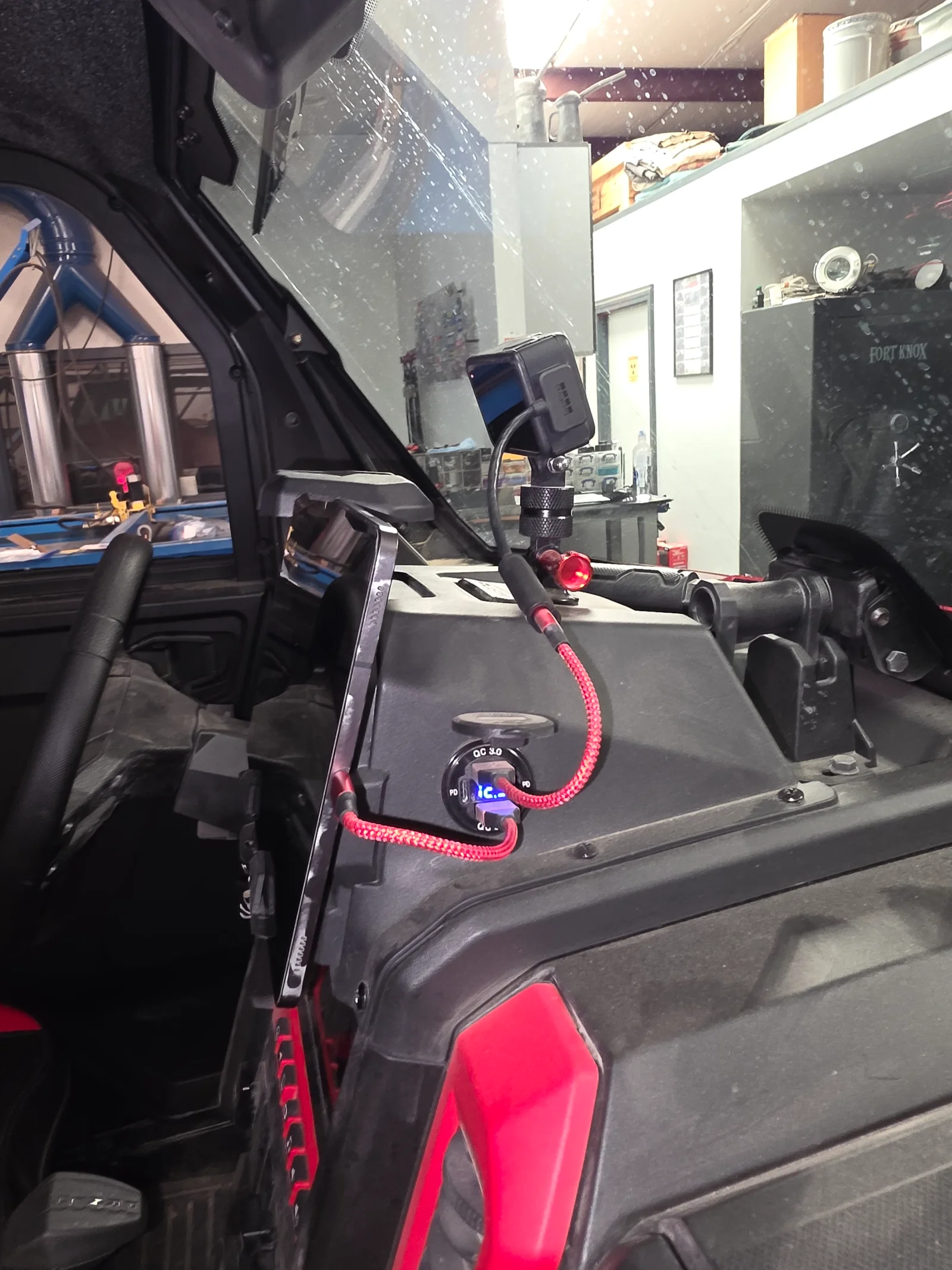

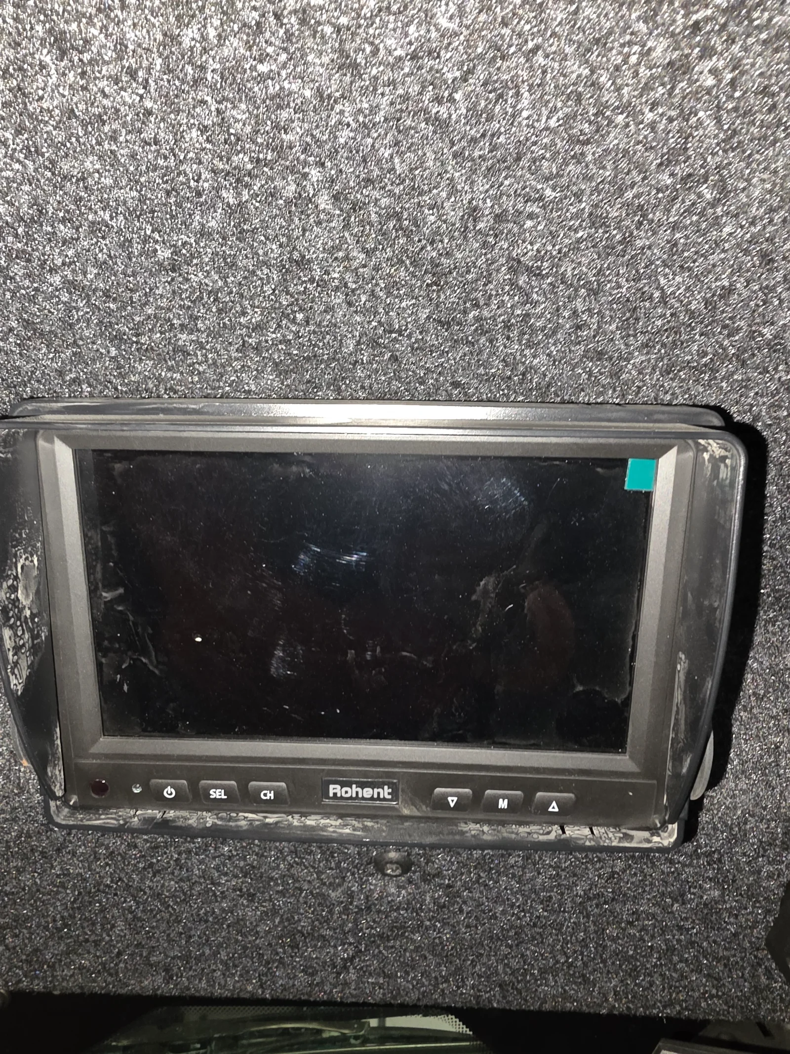

Here's a photo of the 7" monitor and where I have it mounted. Right above the steering wheel where I can glance up and see what's there.

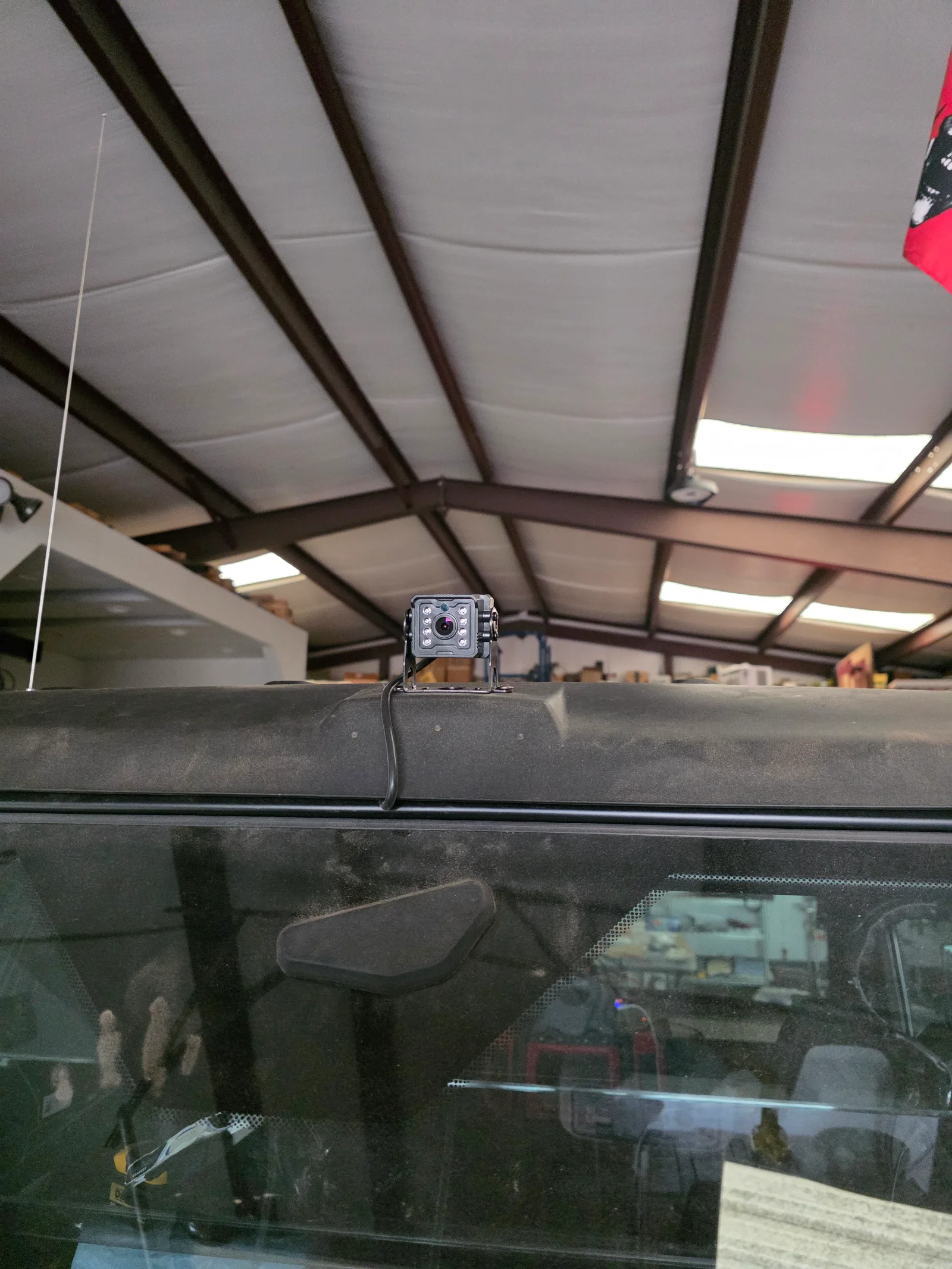

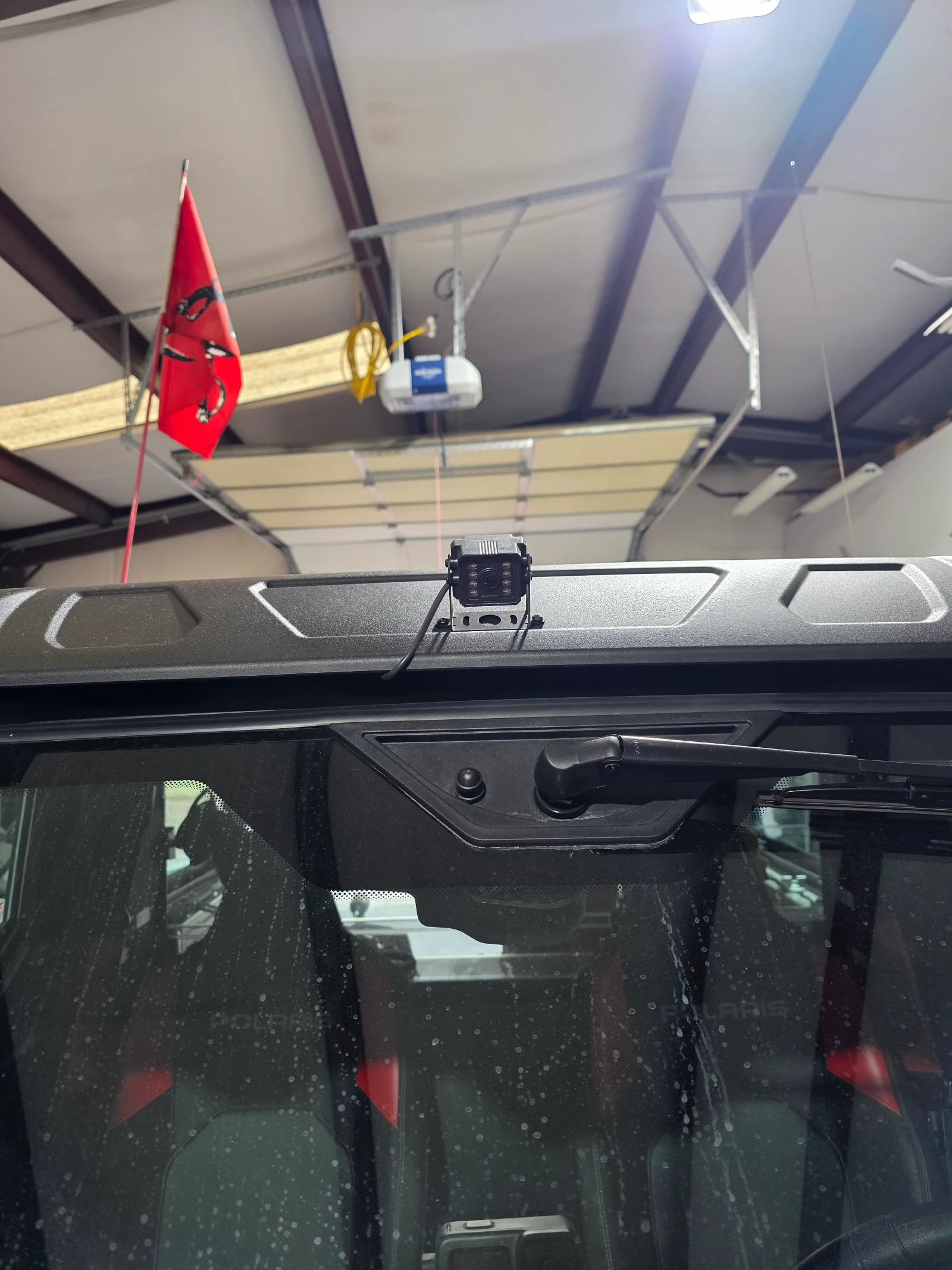

Here are photos of the cameras mounted on the roof.
Front
Rear camera

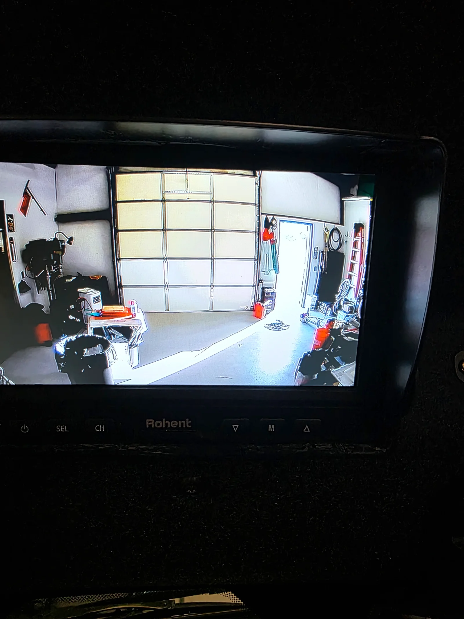

Lastly, here's a photo of what the rear camera sees,
I like the fact that I can easily adjust the camera tilt to see what I prefer.
The front camera is set to get a good view as I come to the top of a ridge. A much better view of where the trail goes after topping the ridge.

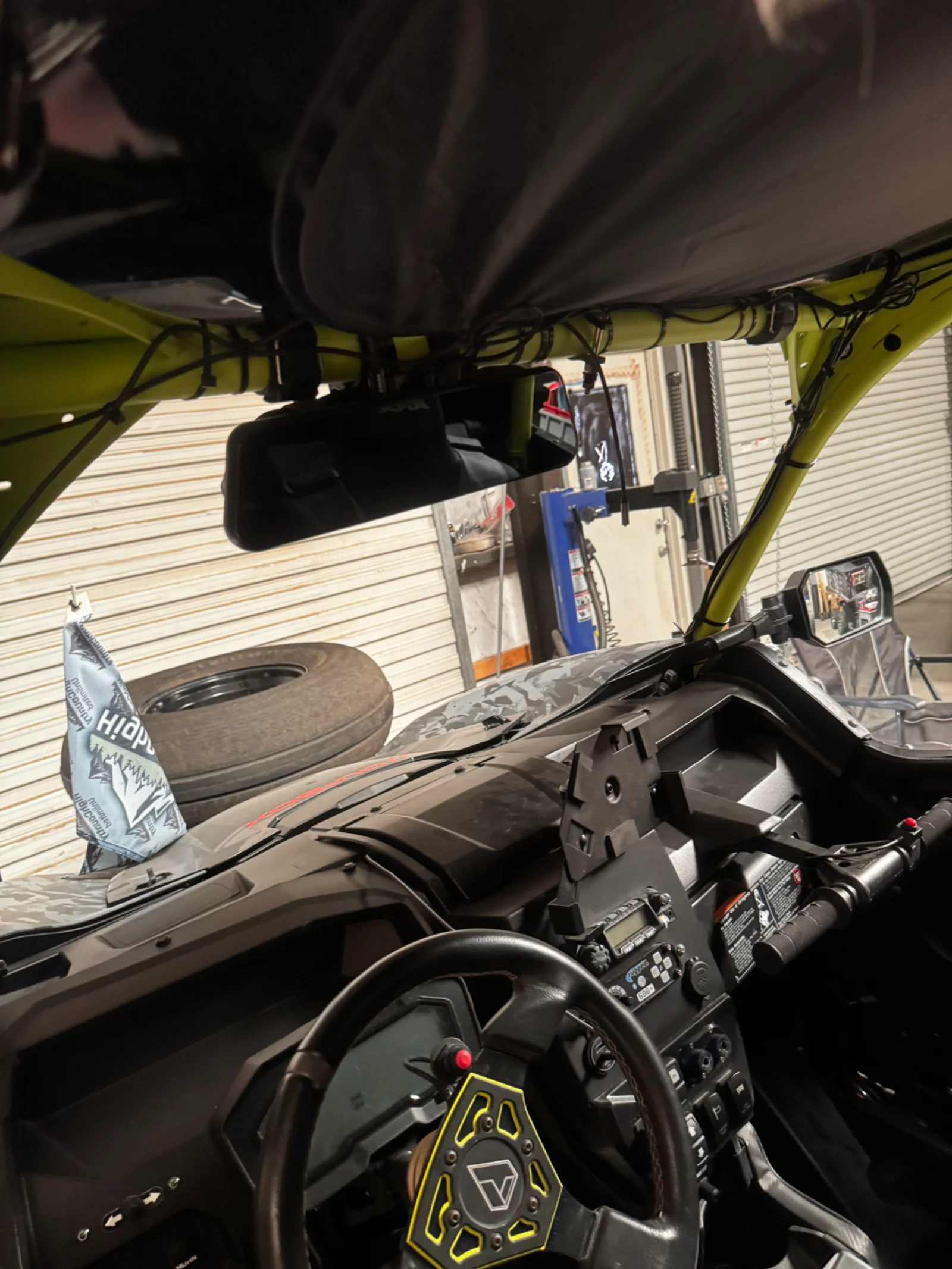

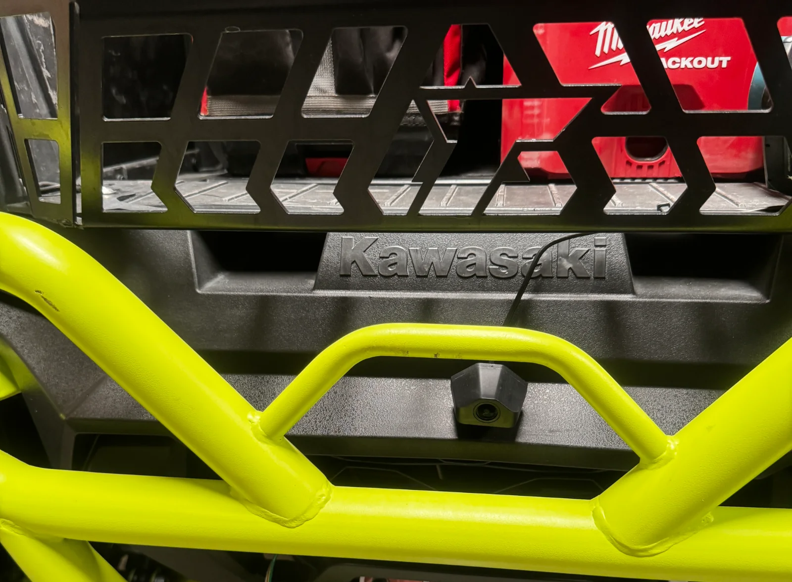

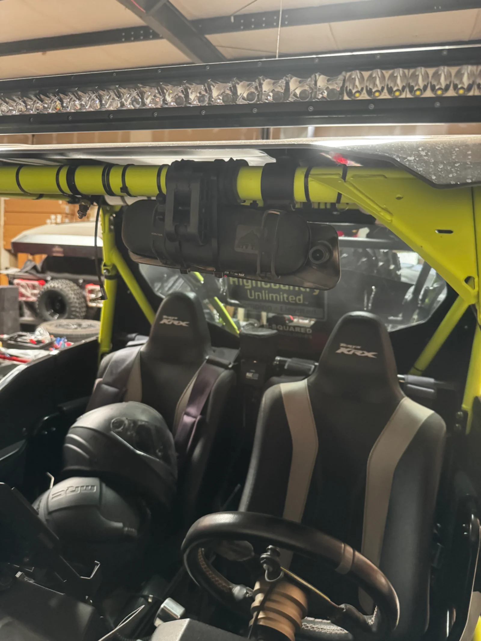

A much more expensive option is the Wolfbox G900 pro 3 channel.
It’s a dashcam system that records and shows from 3 different cameras.
The basic kit just straps over the rearview mirror, but you can get a bracket to replace the mirror. The mirror part has a 4K camera, the rear camera is 2k, and the third camera (can be a bumper camera or wherever you want to put it) is 1080p.
We have one installed on our KRX and it’s been really handy, since the rear view is blocked by the spare tire.
You can select which camera you want to be on the screen, or have all 3. You can also adjust their angle a little onscreen.
WOLFBOX G900TriPro Bumper Version 3 Channel Rearview Mirror
