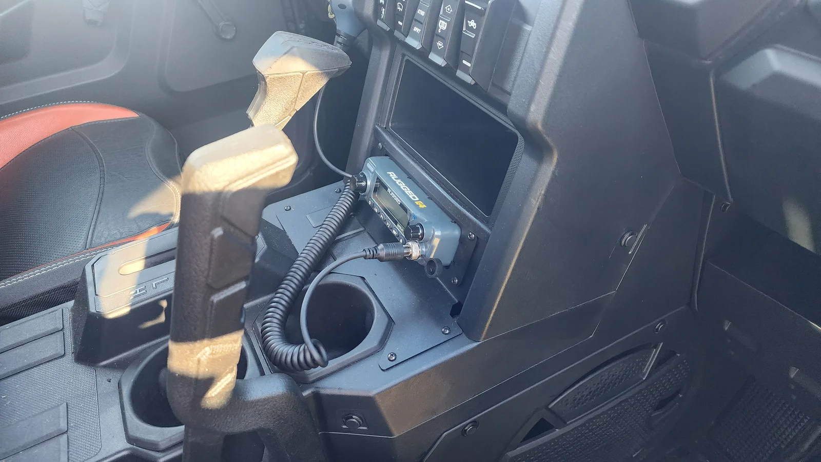

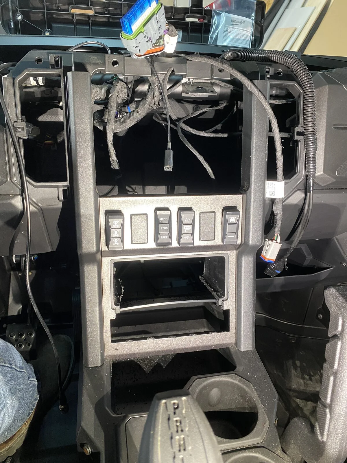

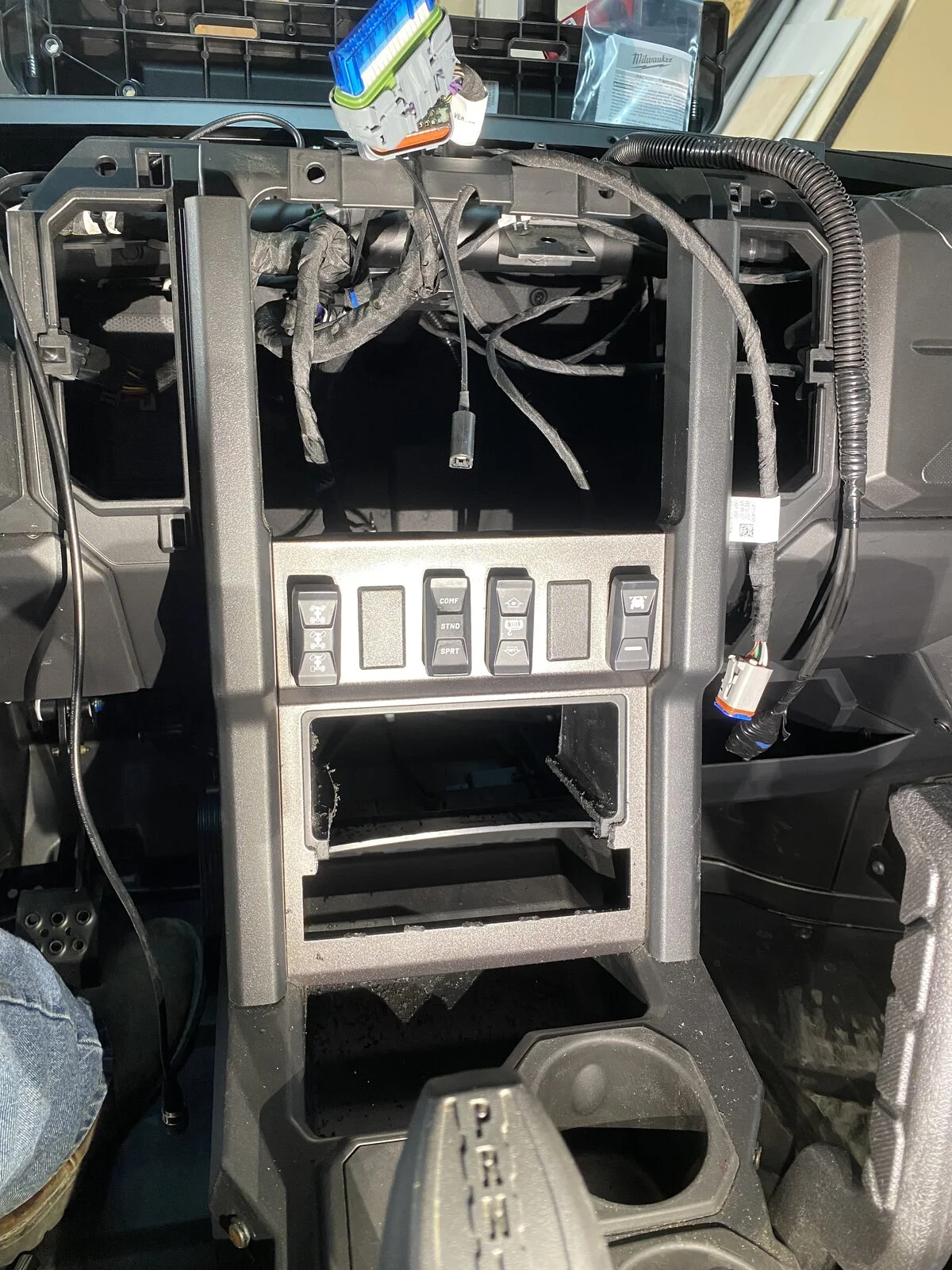

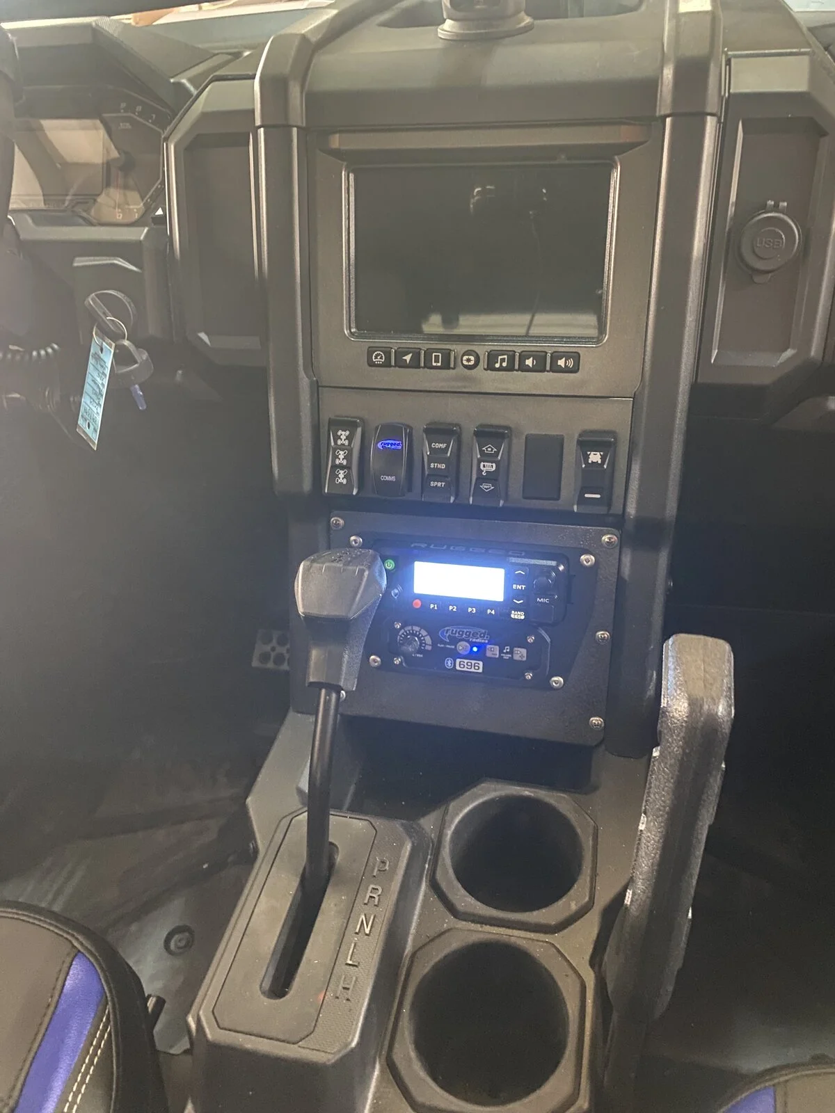

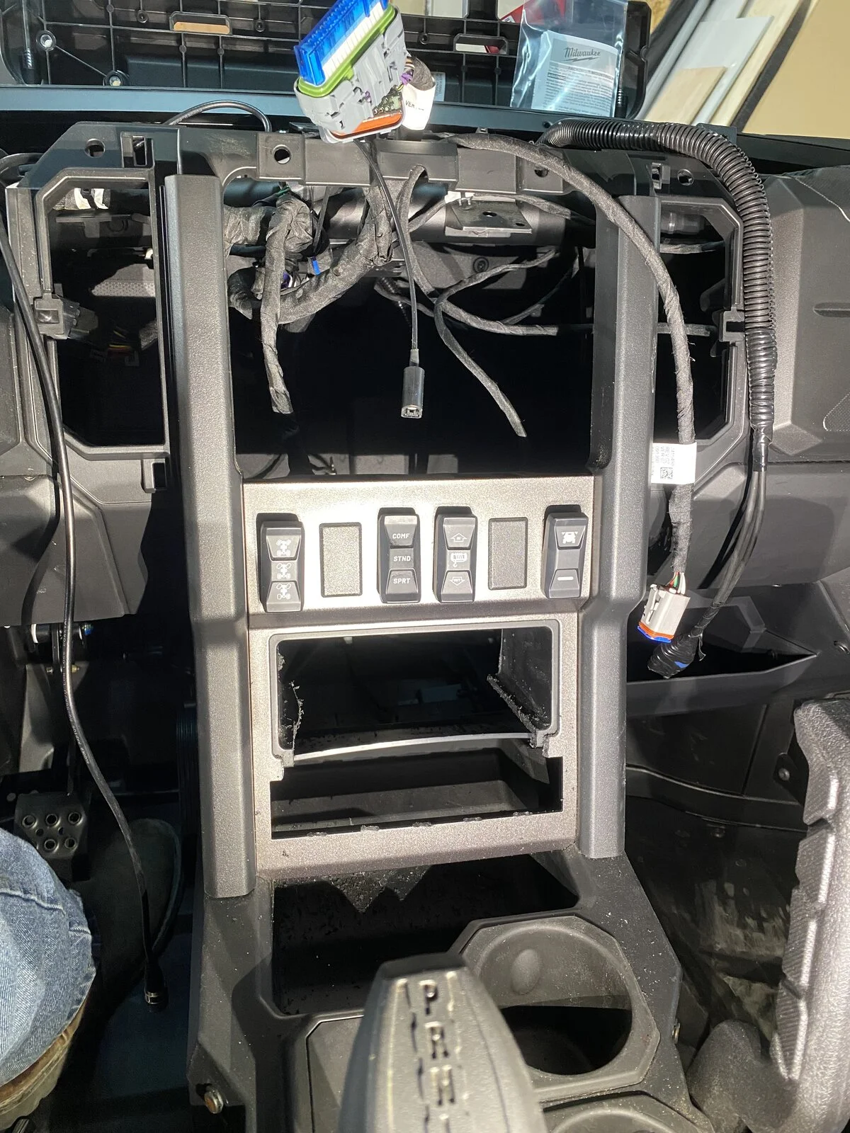

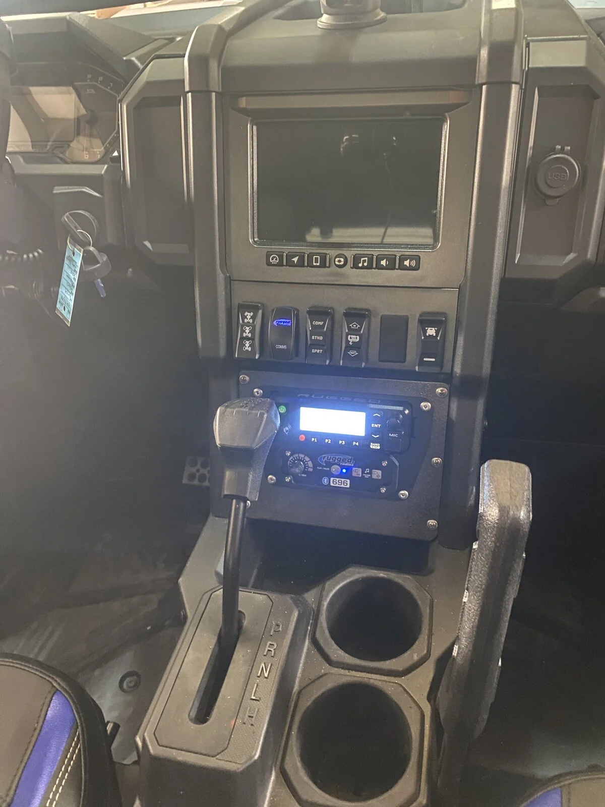

So yeah, I have coms and radio… but we did ours before Rugged had a solution for the Xpeditions. Also mine and my brother’s Xpeditions are Ultimates, so I cut out the bottom row of switches and the pocket where the hvac controls would be, and built my own mounting plate.
The PTT buttons were strapped, one to the steering wheel and one to the passenger grab handle, but the steering wheel pinched the cable, so I robbed the passenger one and now have it run to the shifter instead
View attachment 4545View attachment 4546

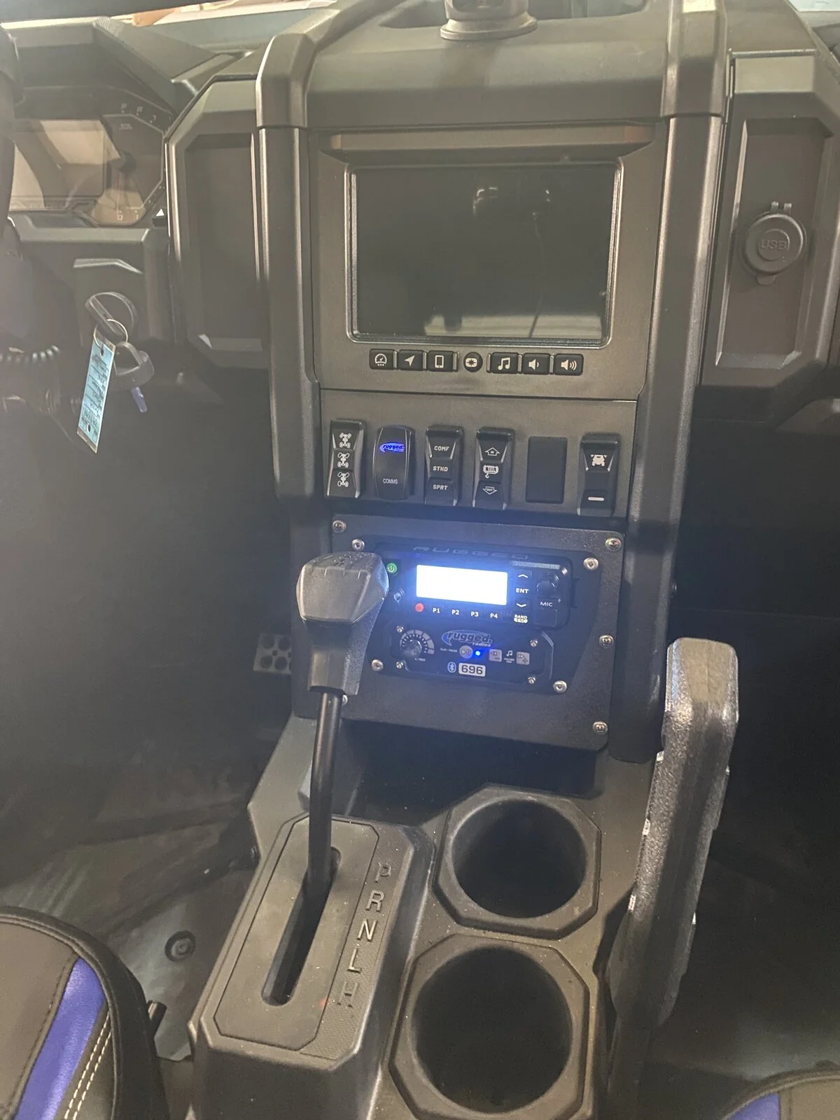

The guys are using the Rugged Radio mounting solution to install my radio and com as we speak my question is do they still put the PTT on the steering wheel or is in a button on the console ?
They typically do the ptt on the steering wheel, but rugged offers toggle ptts that can go in the switch slots on the mounting kit. I didn’t like it on the steering wheel. It kept pinching the cord between the wheel and column. I wound up strapping it to the shifter.
They ended up doing the toggles like you stated JT !!

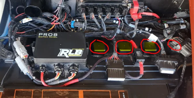

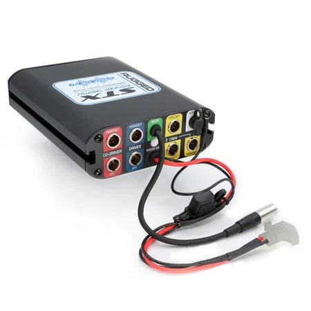

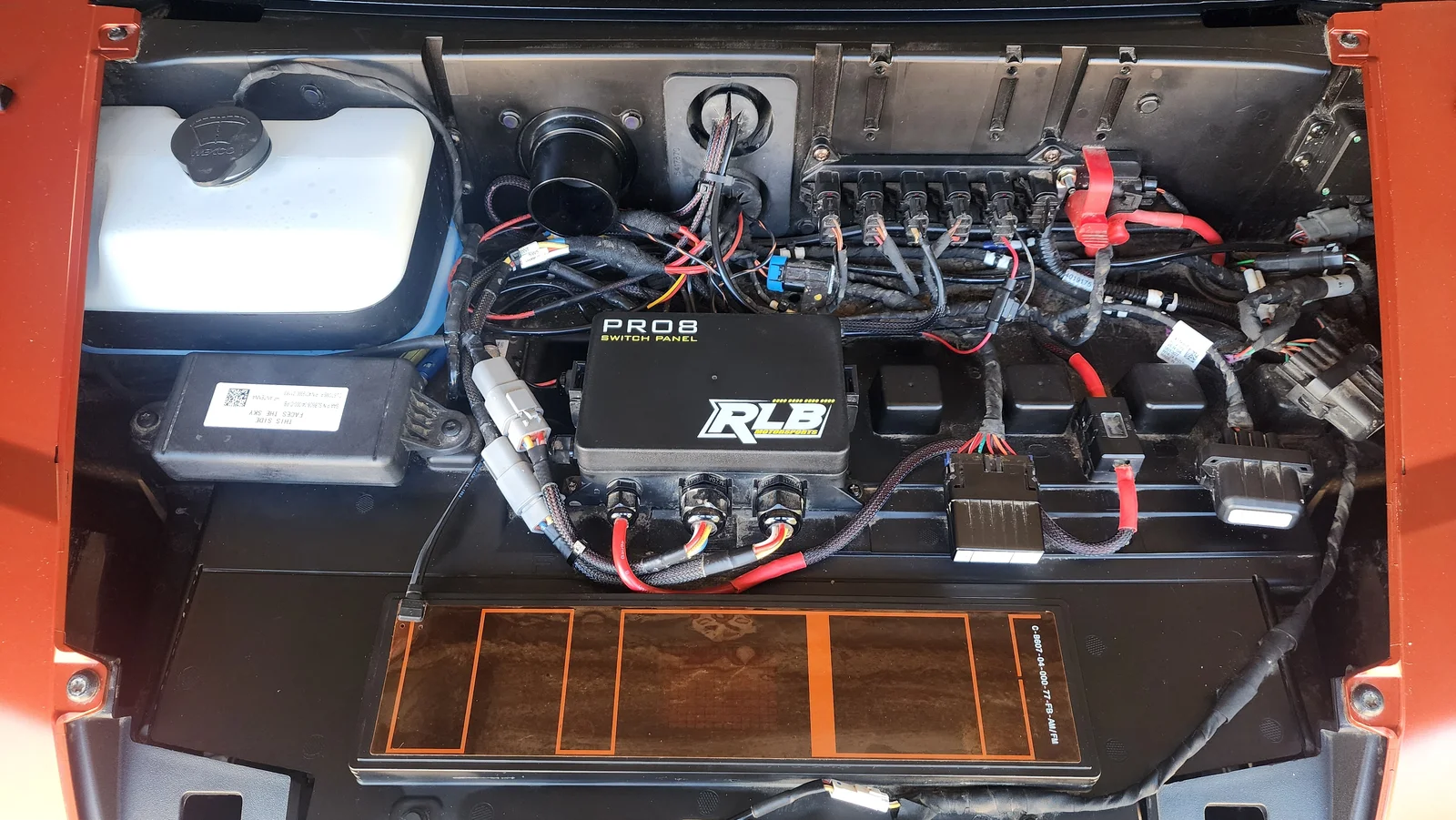

I will try to get some pictures of mine tonight but it is mounted right under the hood....I modified that area and added a piece of sheet metal because i had so many things to mount under there. The STX system works great....also don't forget that you can add the STX as a "headset" to your ride command....that way you never actually connect your phone directly to the STX...hope that makes sense.
you aint seen packed yet :ROFLMAO:.... I trimmed all of those plastic thingy's off( i guess they are for mounting relays) and put a piece of sheet metal across the whole thing....I have the intercom and Alpha 12 in that area(where your RLB is).....had to put the WD in the passenger side and the Eclik on the driver side....i will get some pictures but I'm a little embarrassed of how messy it looks....its actually not as bad as it will look in pictures.....everything has a place and it is all firmly mounted there were just so many wires....you might could fabricate something for behind the ride command to get the intercom mounted.
