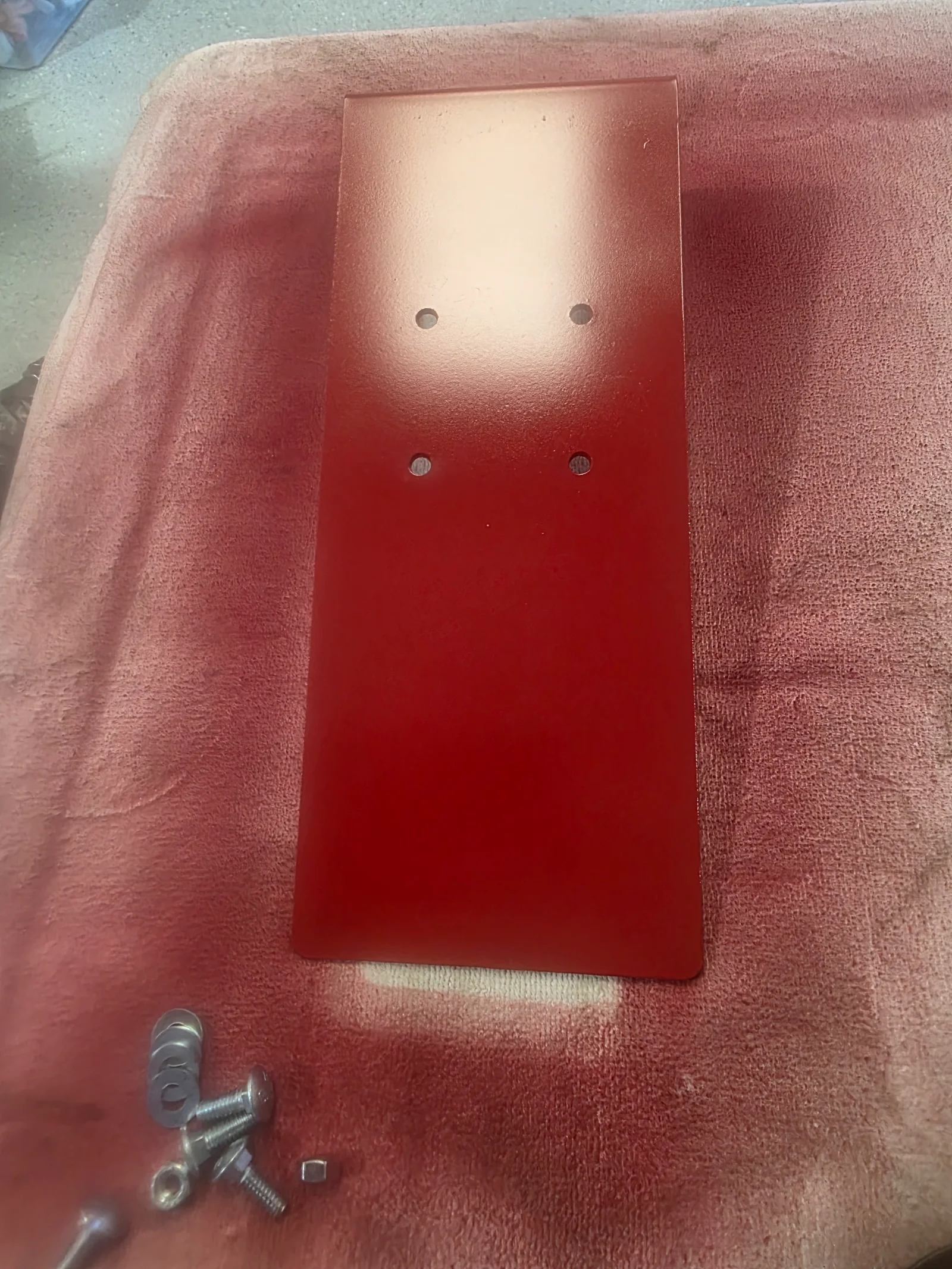

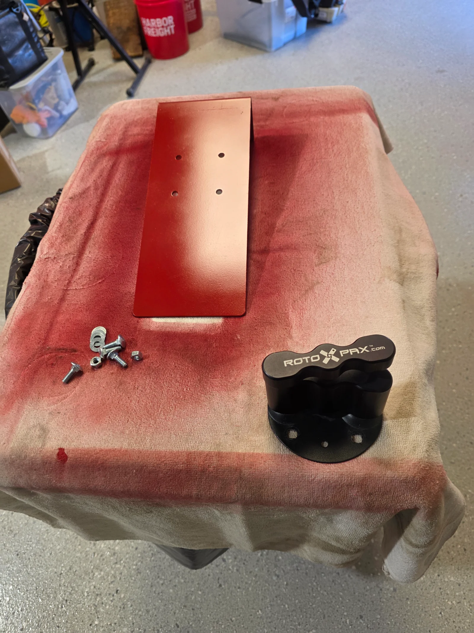

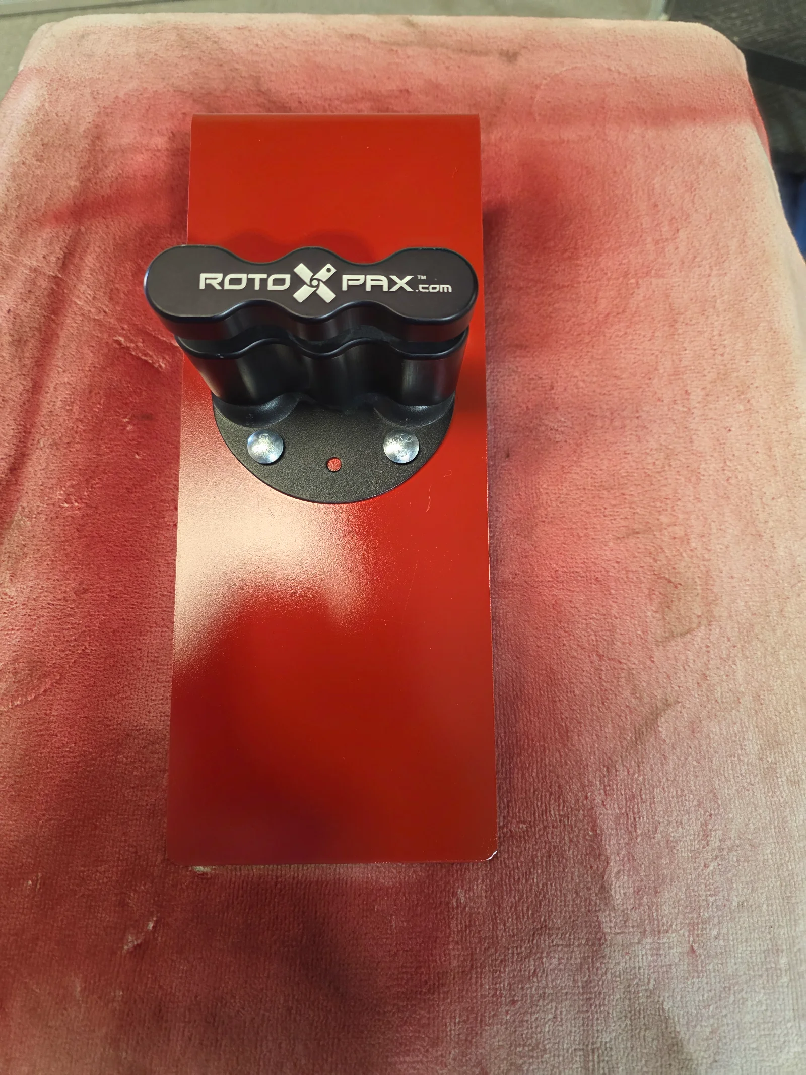

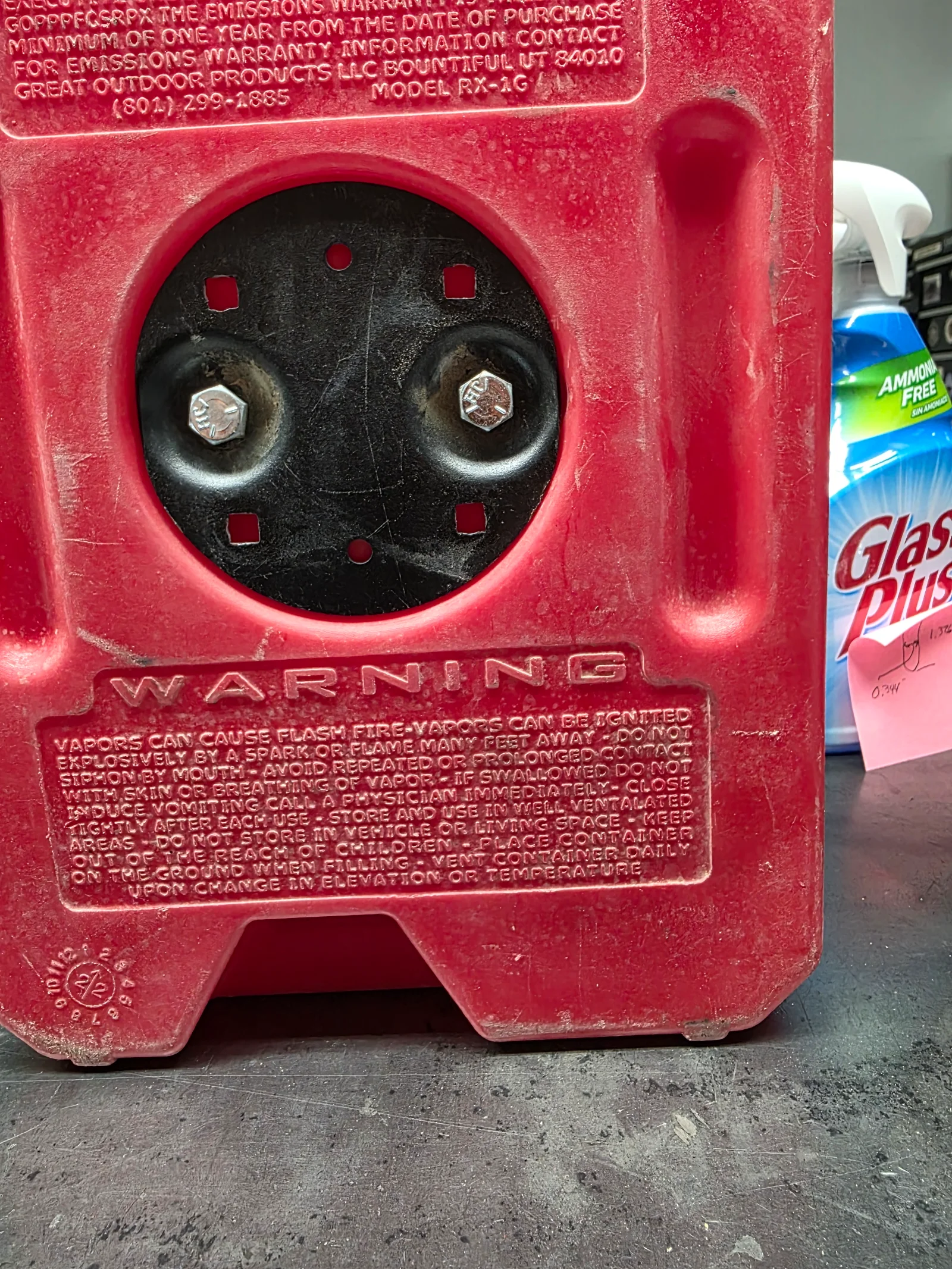

Most probably know this. But here is a photo of the Roto-Pax container and the backside of the Roto-Pax mount.
I designe my mounting bracket using Autodesk Inventor. Cut it on my PlasmaCam CNC plasma cutter. Bent on my Shop Outfitters bending brake.
Not bragging. Just how I did it. Would like the opportunity so possibly sell some. Thoughts? Thinking $35 plus shipping?

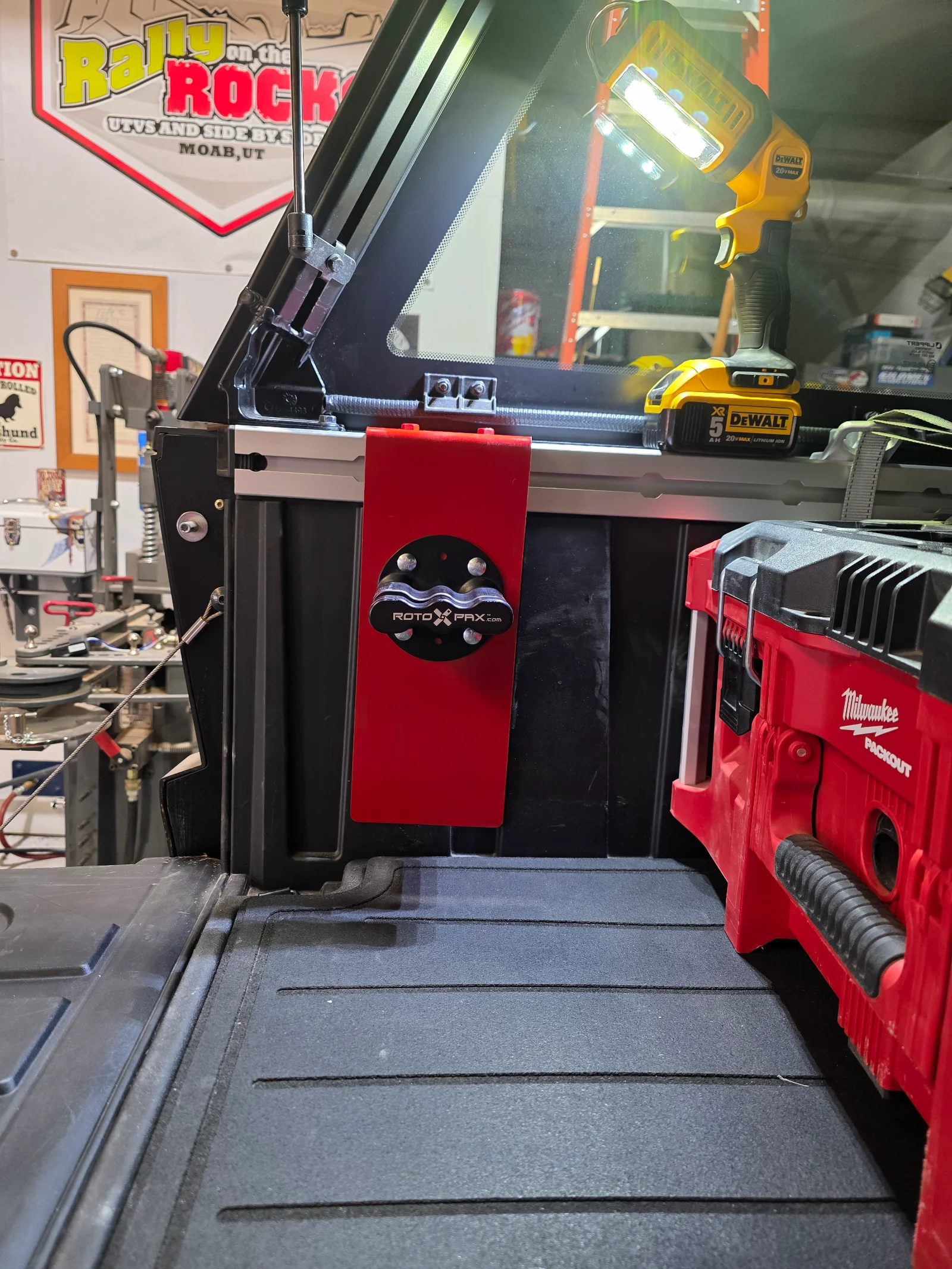

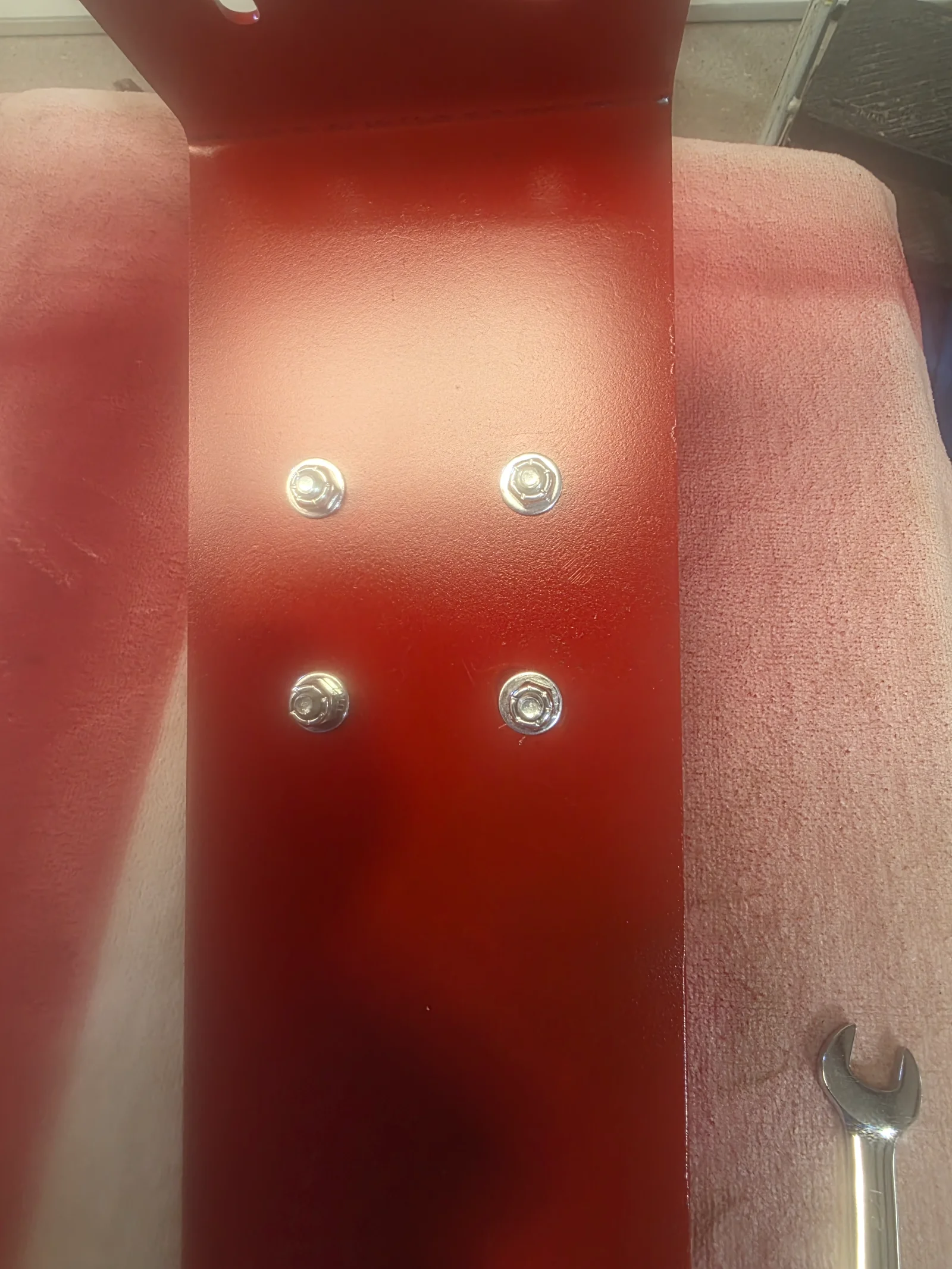

Bolted the Roto-Pax mount to my mount:

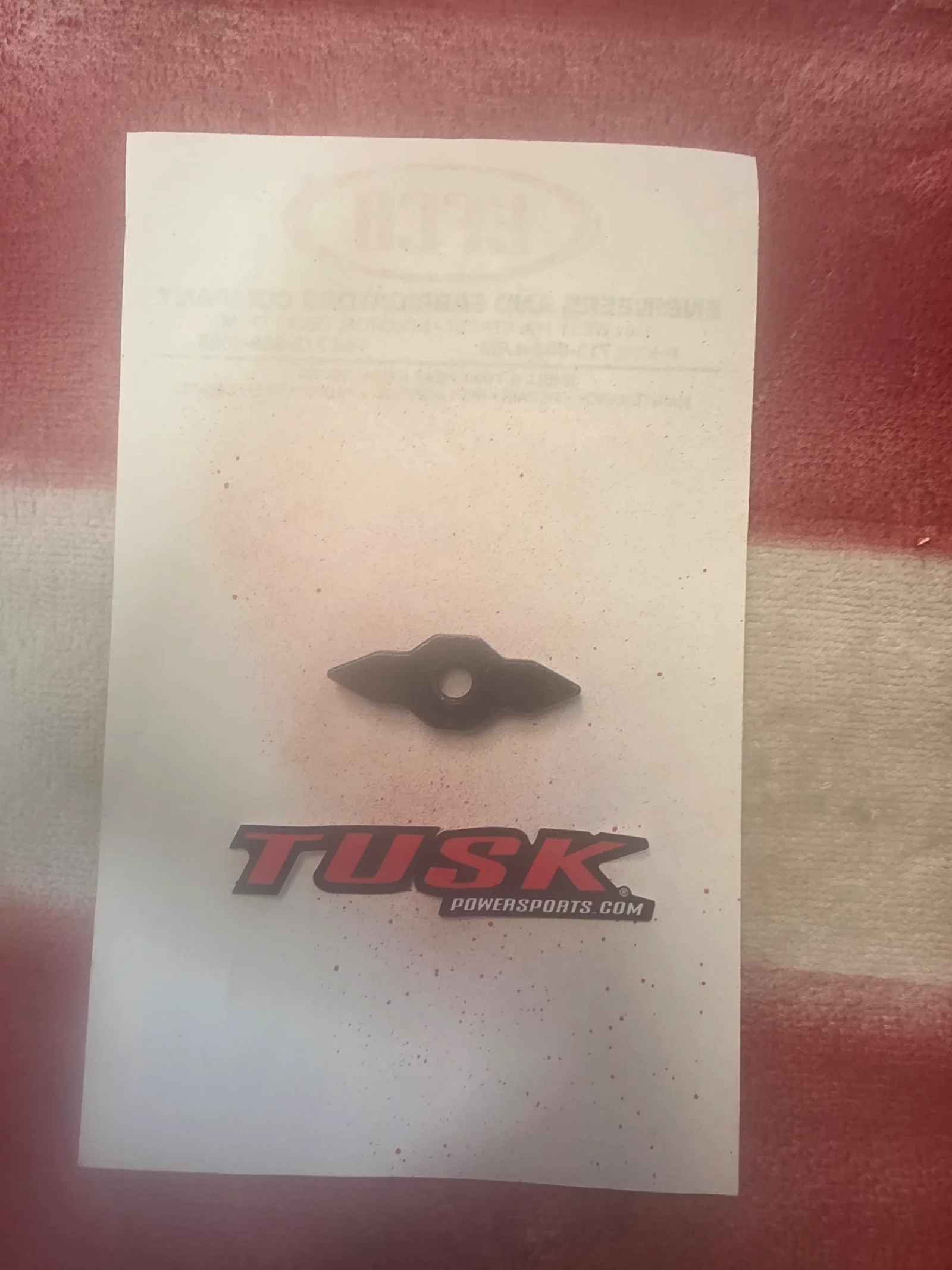

Used Tusk threaded pieces that fit in the Polaris side rails they are 8mm. Used two 8mm flange bolts:

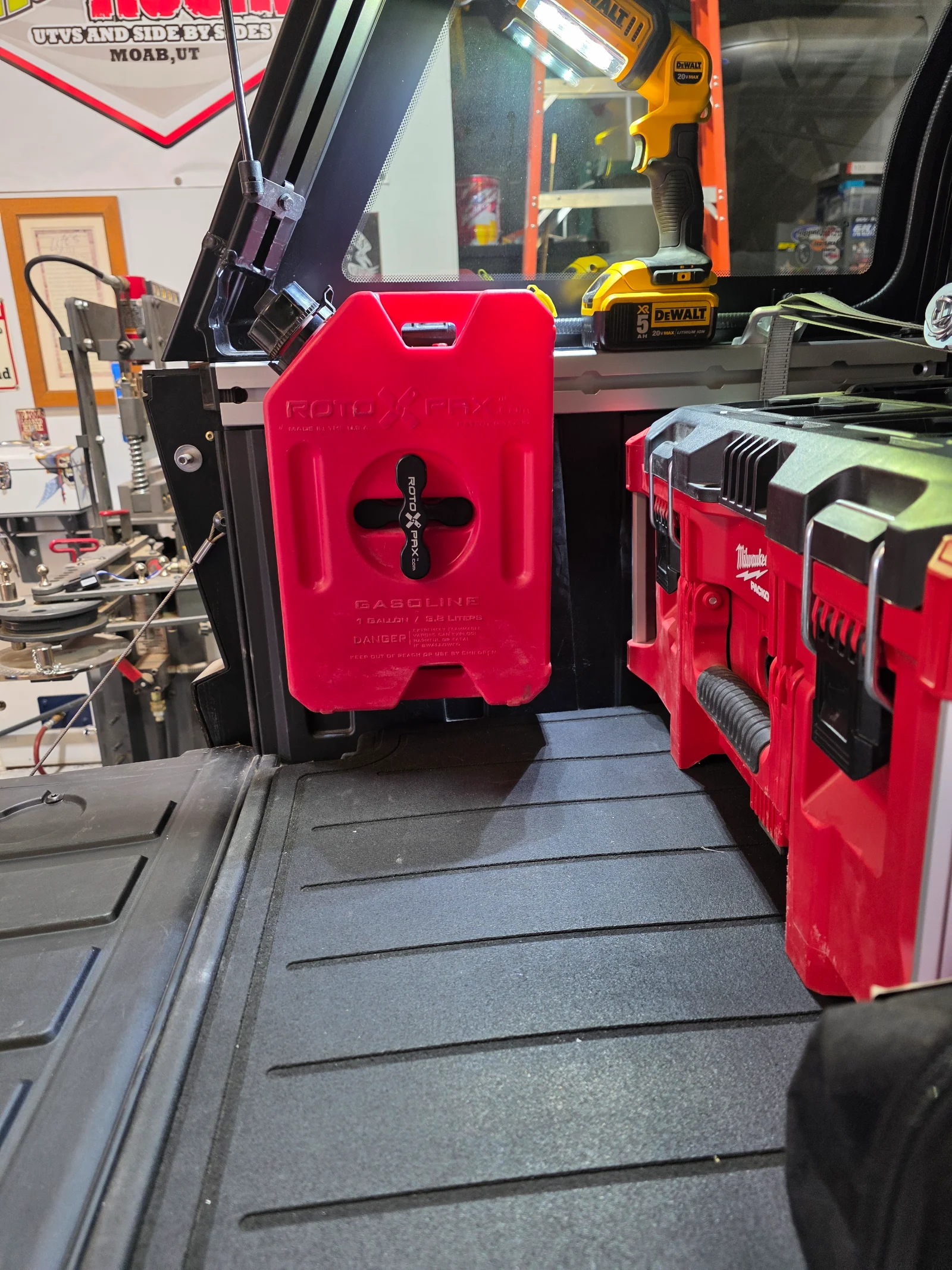

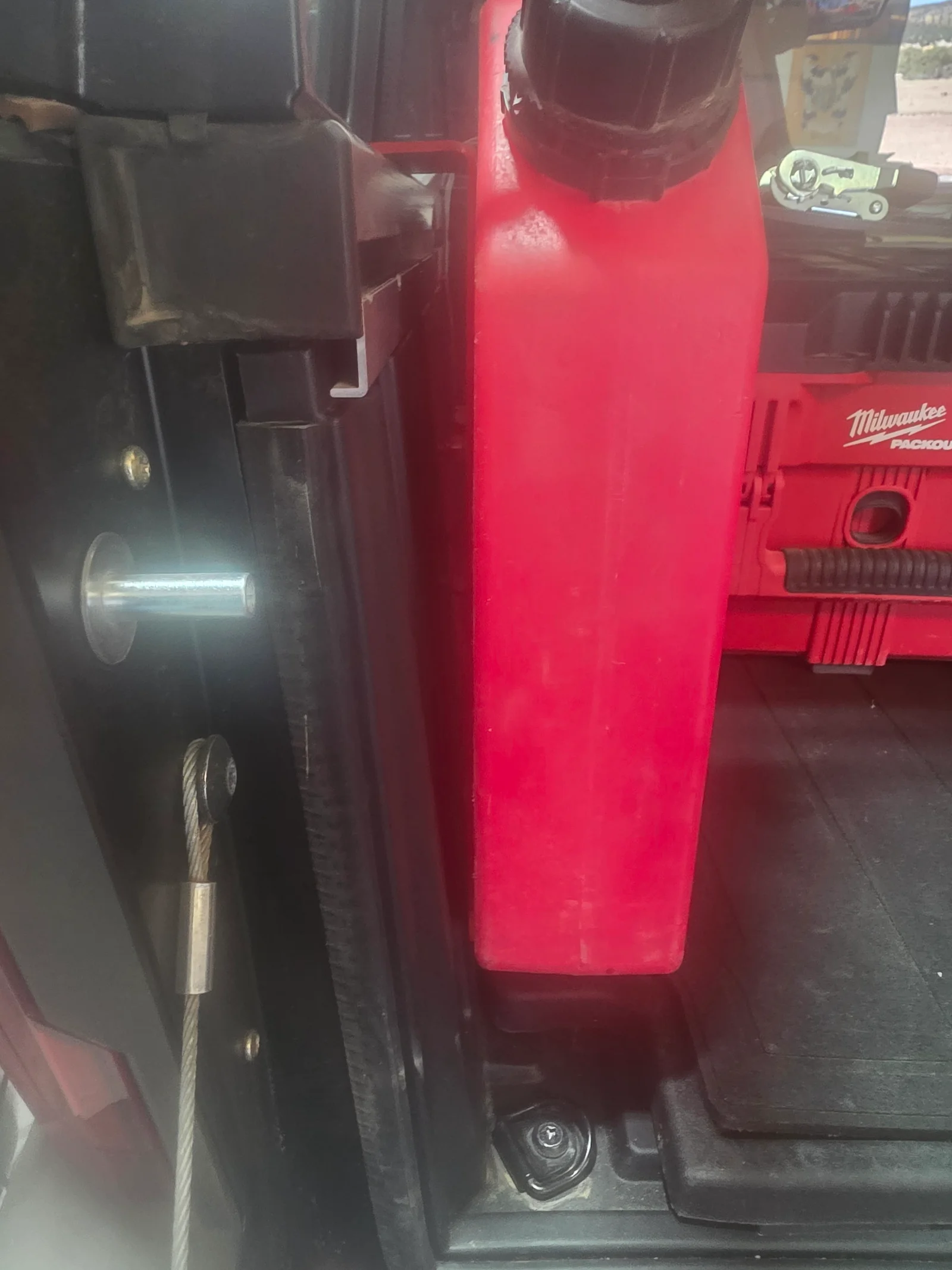

The gas container mounted:
Mine mounts the container off the bed another means of not getting it damaged.
Here is a end view. The bracket holds the container vertical. Hoping this will prevent
sloshing and leakage.
