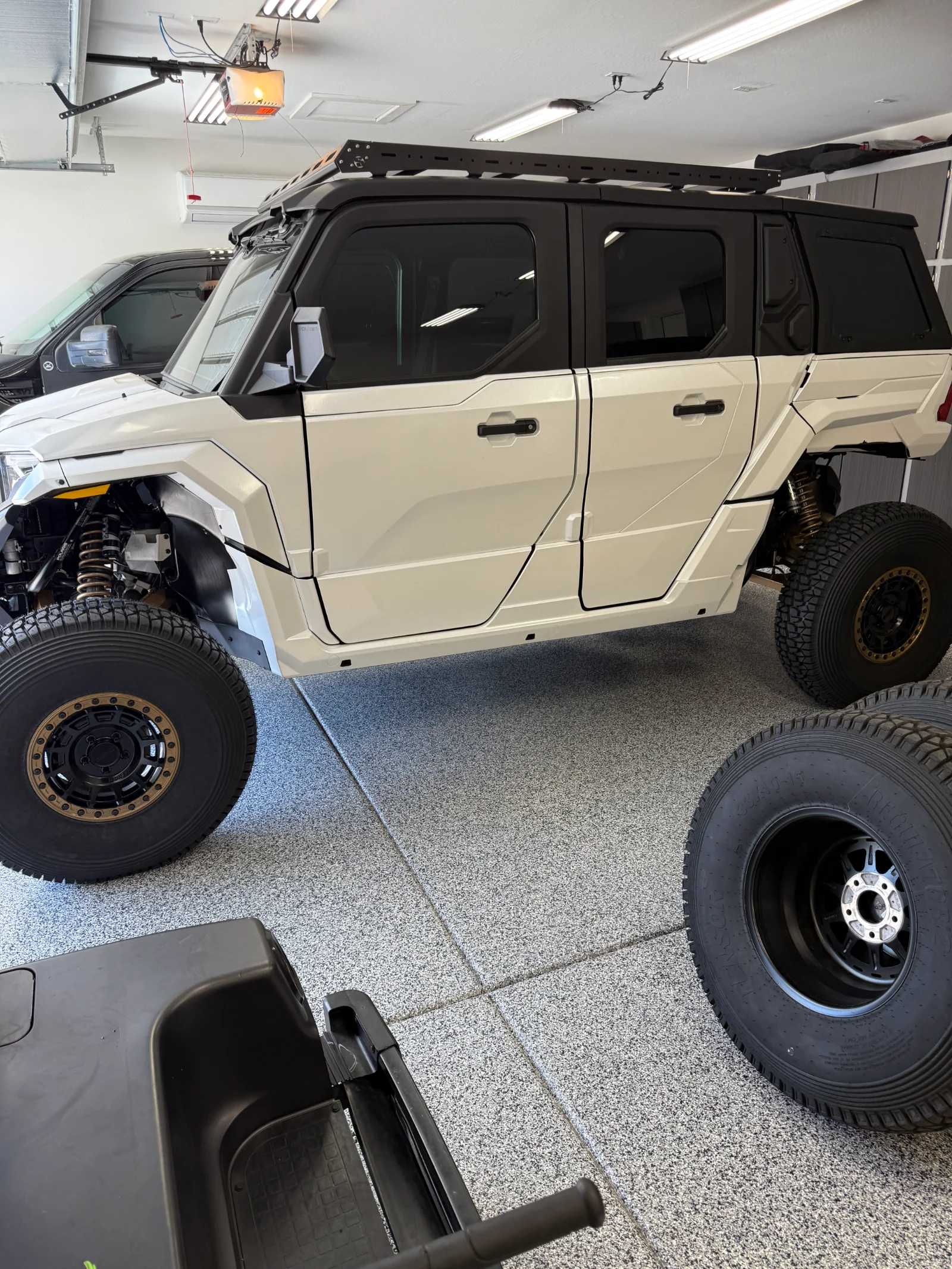

Hello, are you running wheel spaces as well to get the 35's to clear? I am running method wheels with 35" tensor tires with the HCR kit and I am rubbing really bad. I have an EVO turbo kit, Tune, & Clutch. It is plenty fast with the 35's but, it did seem to handle much better with the 33's
Hello, are you running wheel spaces as well to get the 35's to clear? I am running method wheels with 35" tensor tires with the HCR kit and I am rubbing really bad. I have an EVO turbo kit, Tune, & Clutch. It is plenty fast with the 35's but, it did seem to handle much better with the 33'sView attachment 6013
Did you ever get this resolved ?
Looks BA by the way.
I have sent the car to Shock Therapy and I am hoping that this will help with the correct springs and valving. Once I get the car back I will circle back and post the results. I still think the best thing to do is just get the tires away from the car but not a huge fan of running wheels spacers even more so when I buy a set of wheels already.
