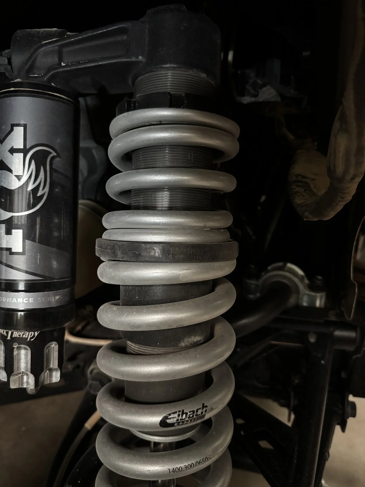

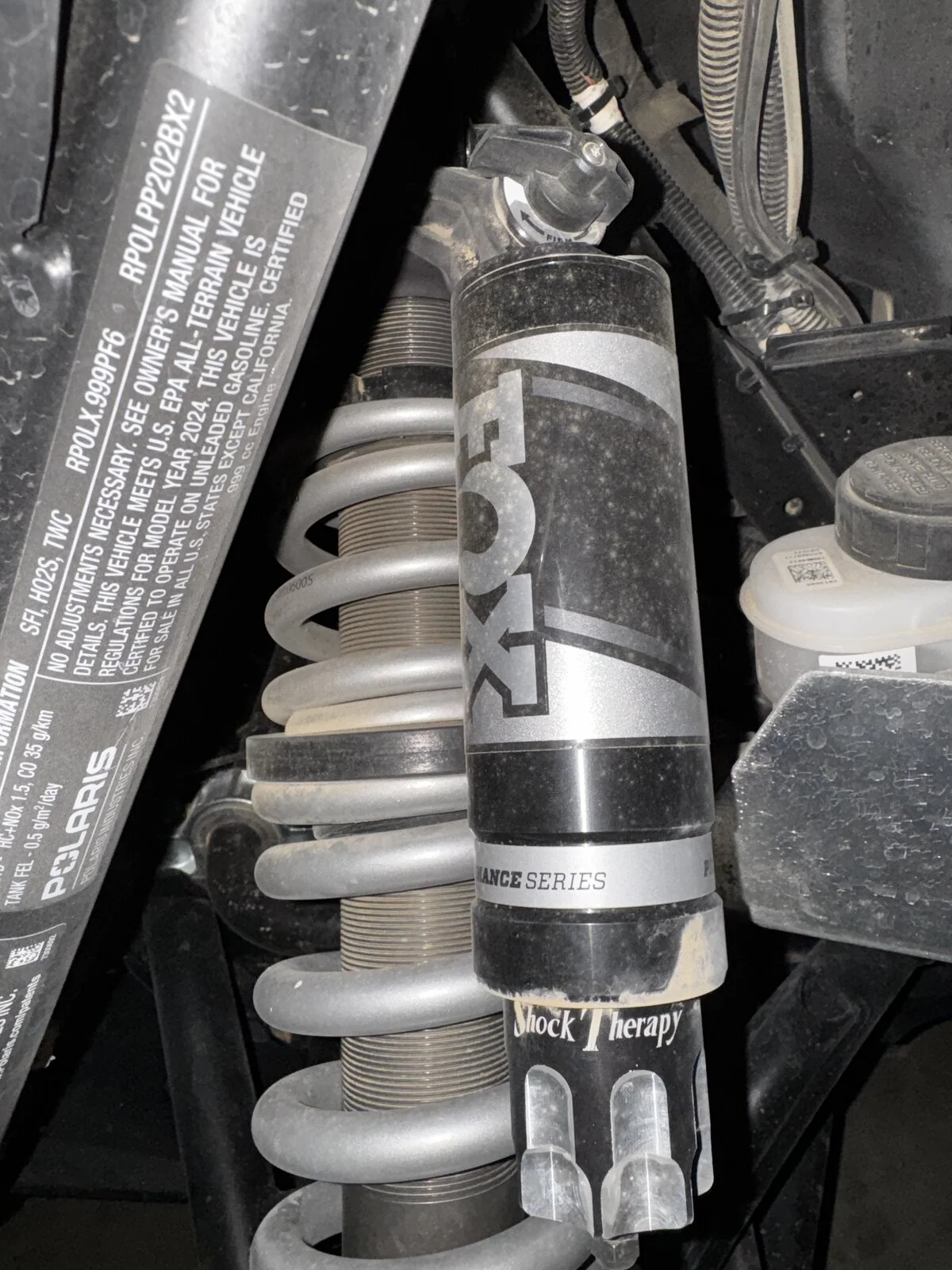

View attachment 4541View attachment 4542
Yep I’ve always felt my ST springs were low on spring rate. My rear is definitely more compressed than yours. Their answer was to add preload. I don’t want to drop another $900 on springs so I’ve just run with it.
The MTS kit I just put on had 410 over 410 in the front and only has 1” of preload. I didn’t notice the rear rates before powder.
My ride height was measured with my 32-in tires which actually measure about 31 and 1/4
