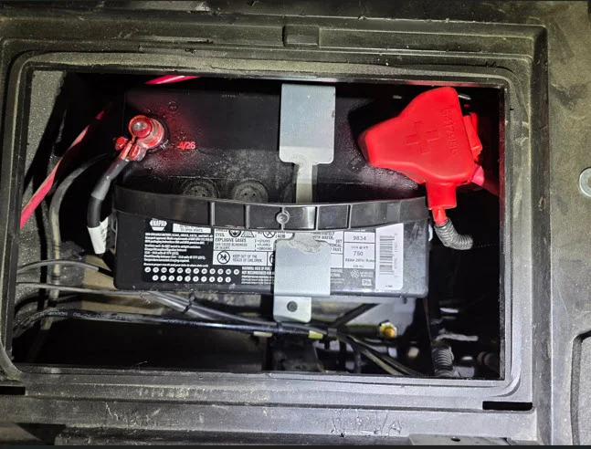

I purchased a NAPA The Legend Premium, model 9834, AGM battery the same height but two inches longer than the original battery. The battery posts are in the correct locations. It cost me $233.99
I took the two small devices used to keep the battery in place. This allows the new battery to sit centered in the battery tray. It is long enough. New battery is the same width.
Used baking powder and water to clean the corrosion products off the strap. Set the battery in place and it fits just fine. I chose to leave the battery lift strap in place. I'm sure I kept one
from another battery. Nope, so I left it in place for the next time I have to remove the battery.
Here is a photo of the battery installed, corrosion preventative sprayed on both battery posts:

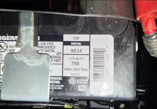

And, here is a photo of the battery label with PN and Cranking Amps:
