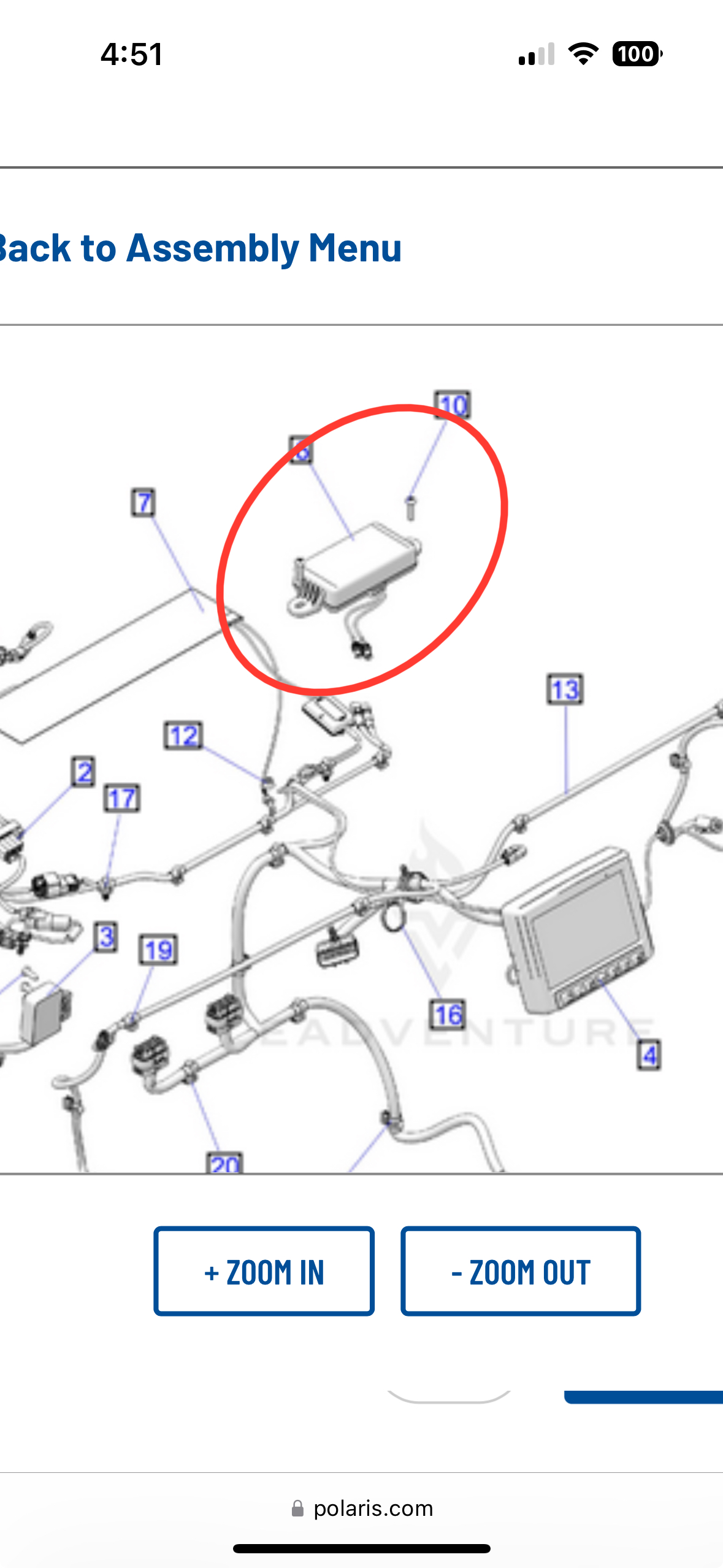

Yes shows our location. We found am/fm antenna. But not the VtoV antenna. It’s supposed to look like a hockey puck. Called the dealer and they don’t know where either. He said they really hide it. Every model is different they said. Taking in on Friday. I’ll update. Thanks
It shouldn’t be hidden at all. It should be on the right side, just back from the am/fm antenna. Having worked on ‘24s and’25s, XPs and ADVs, Ultimates and Northstars, I can tell you the GPS/V2V antenna is in the same location on all Xpeditions. Also it’s a combination GPS and V2V antenna, so if it’s showing your location, it’s there, it may just have an issue with the V2V part or a software glitch. Re-running the latest software update could help it.

I’ll take a picture on a machine as soon as I get back to my shop.

Awe! Excellent! We saw that satellite box but thought the v2v was separate. And a it’s not a hockey puck looking unit. Interesting. Thanks a million. Will update after software update. Thanks again
