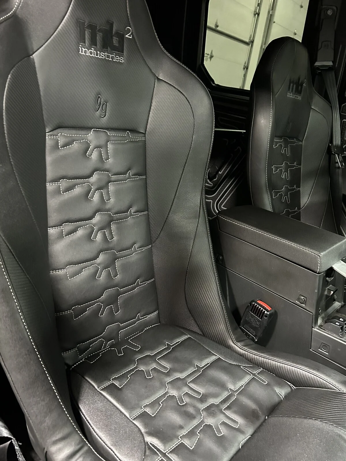

I understand this and was good with the factory seats, just wanted the upgrade. I will say that just the few times in the car now with the new seats, I can tell it will be even better!

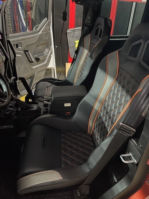

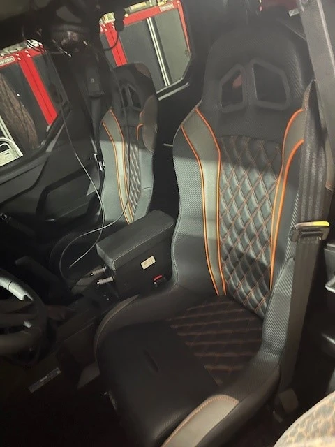

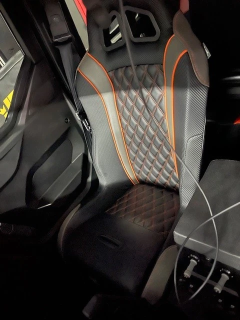

Just installed a set of PRP "XCR" seats in our Northstar ADV last week. Easy install - took about 1 1/2 hrs. Did end up putting 1.5" spacers under the rear of the seats to get them to sit up straighter. They sit up about 3" higher than the factory ones(extra cushion in the seat bottom). It helped me - I'm 6'5". My wife is 5'8" and I had to put 3" of foam on the floor on her side to make up the difference.
Went on a 300 mile trip this weekend and they made a huge difference.
