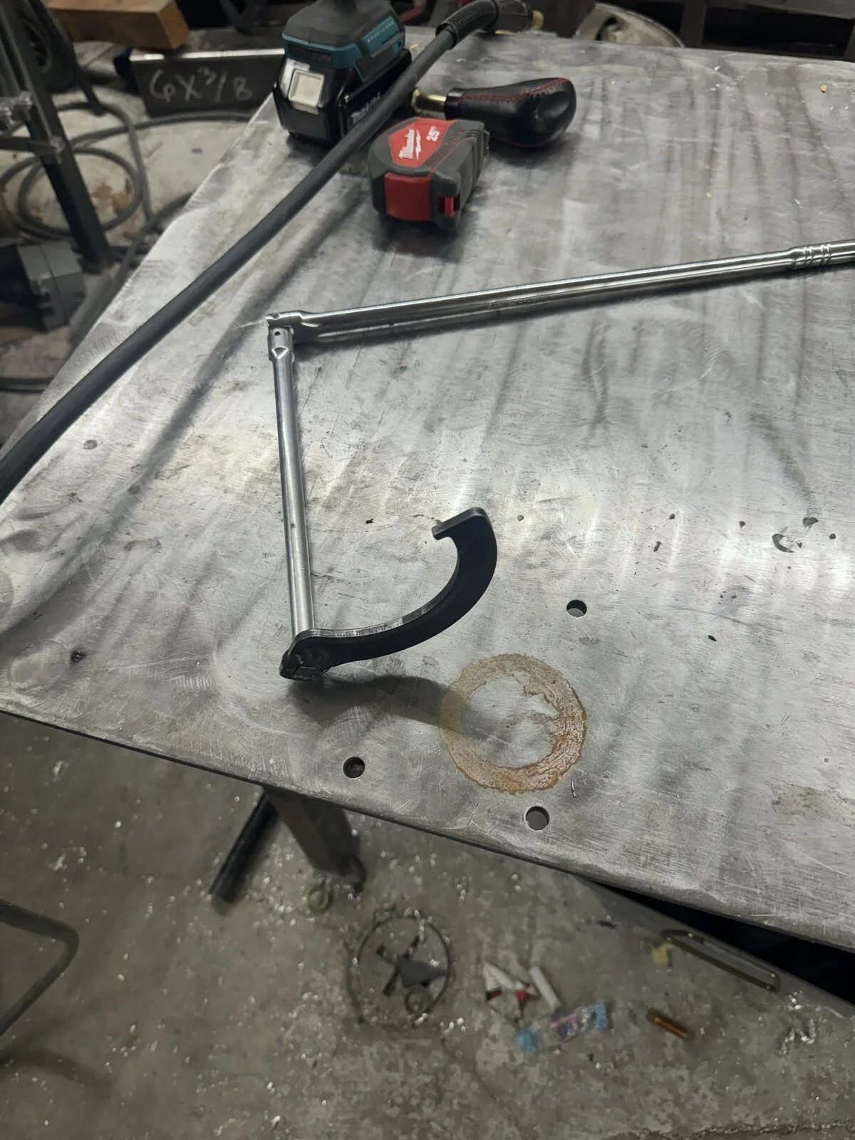

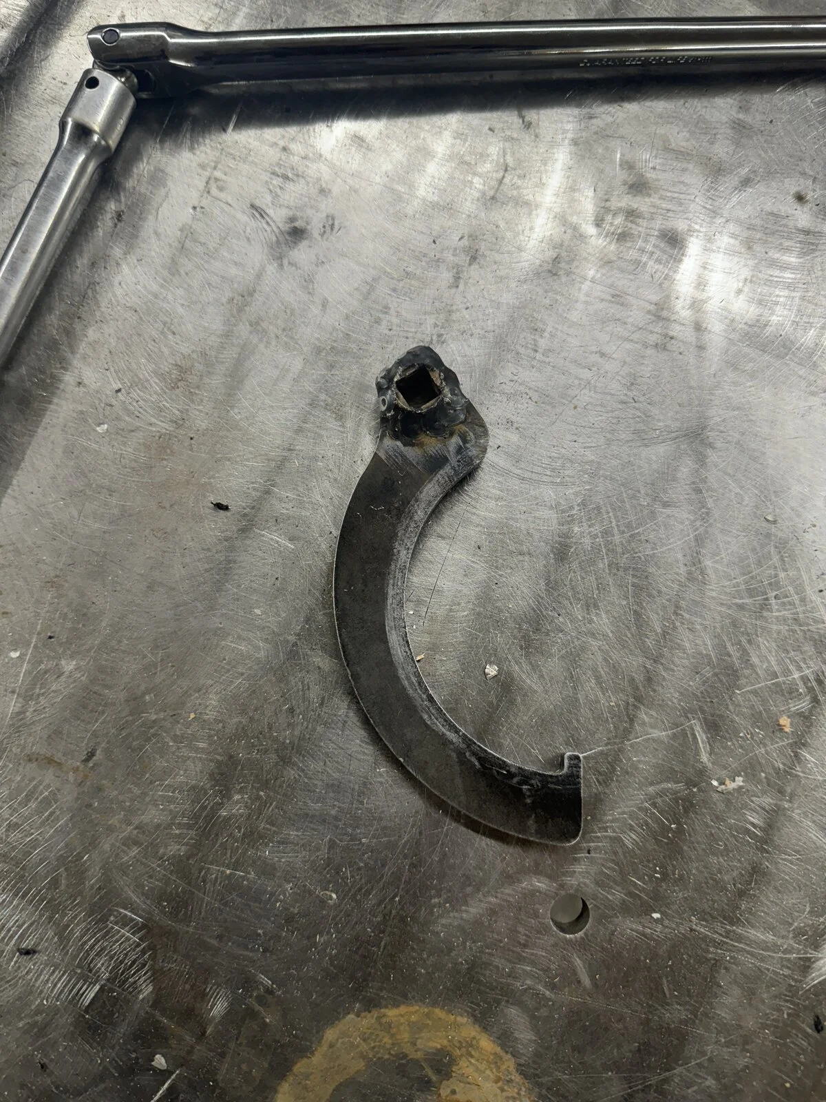

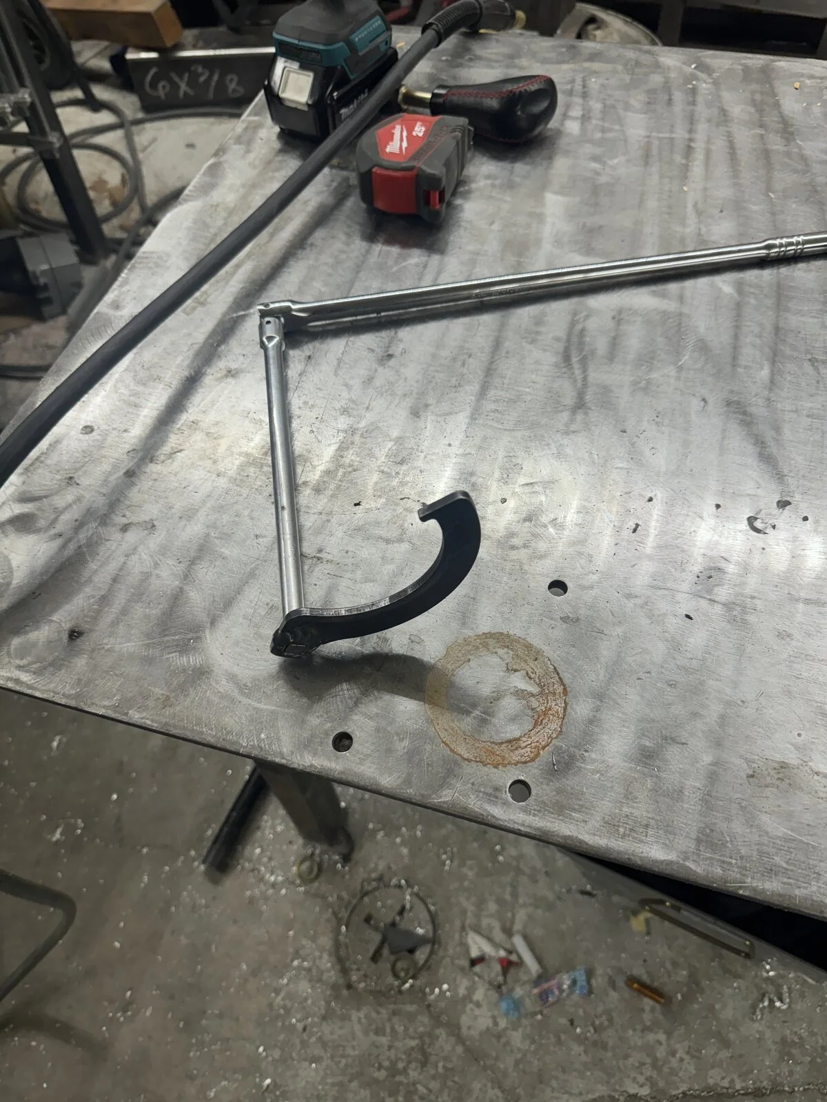

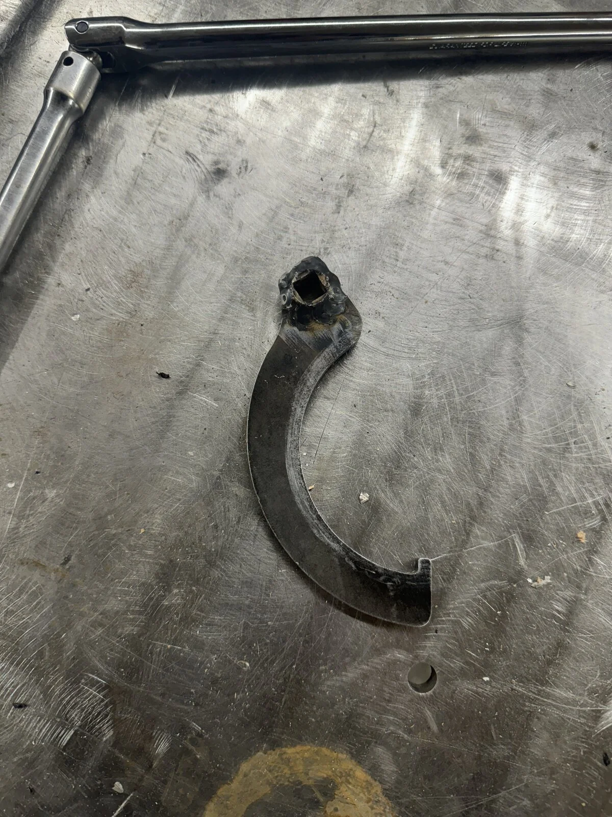

I’ve done both ways but the fronts are easier to adjust off the car and easy to remove. The worst is right rear due to exhaust in the way. Just jack it up so the tires are off the ground and go to town with the spanner wrench. Clean/lube the threads before you start.
I modified the shock tool that comes in the tool kit with the Xpedition so that works like a crow’s foot. A 24” breaker bar makes adjustments much easier and adding extensions brings it down where I can get more swing.
