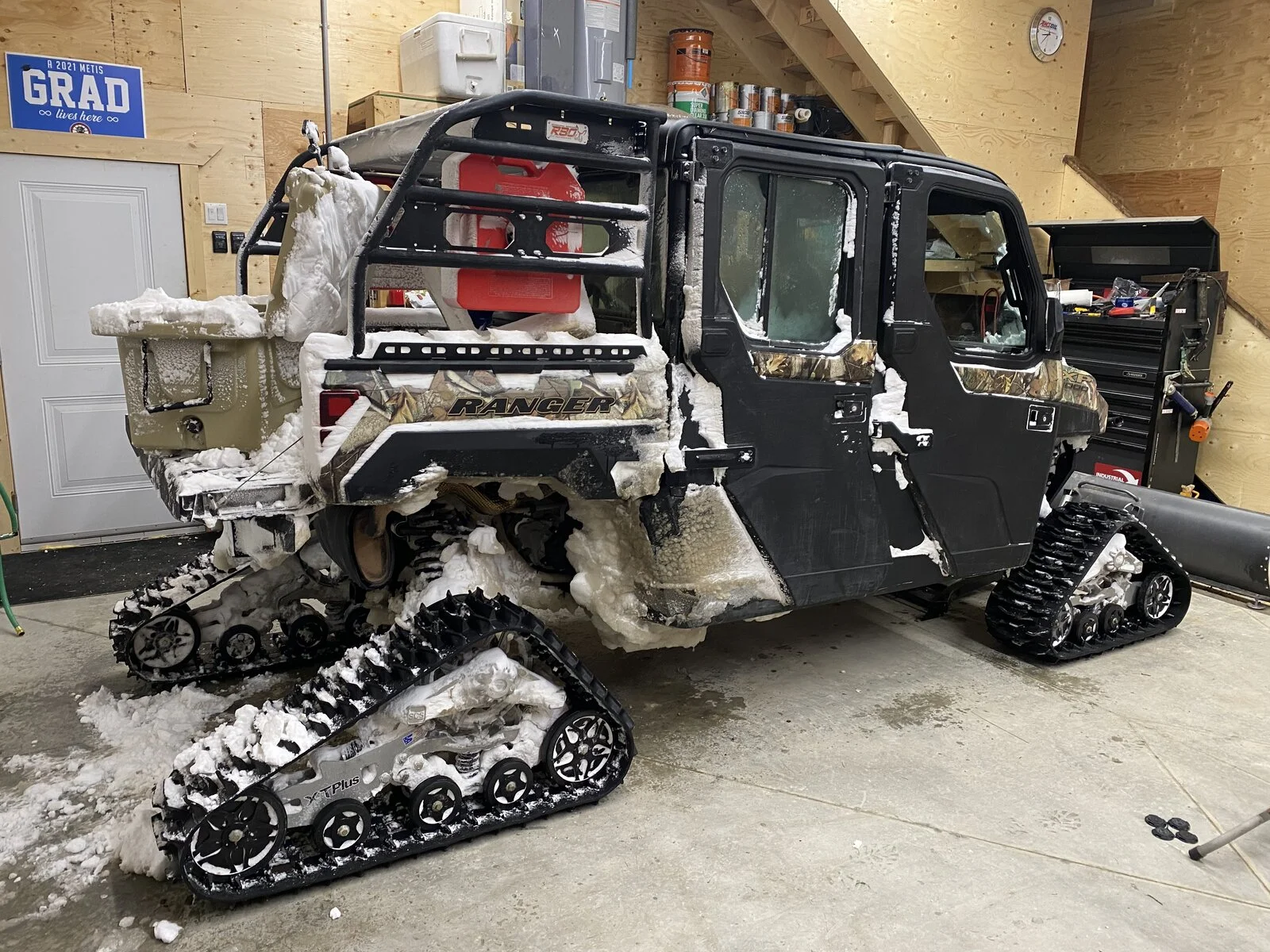

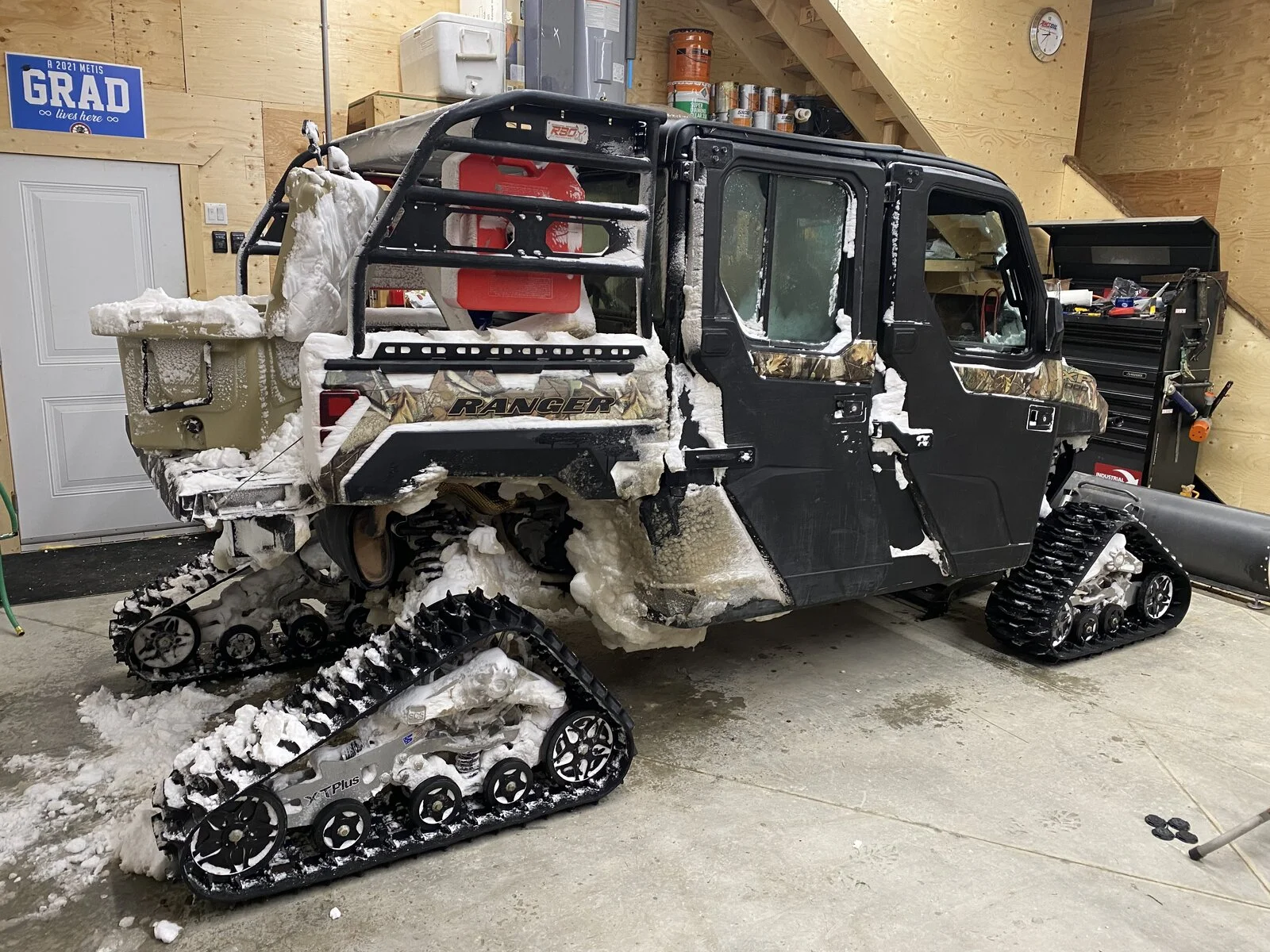

We used APA gloss Miami Blue and 3M gloss bright orange. Installer had some issues with the silver paint peeling so he did a bit of sanding so the wrap held better. So far it look great and is holding up!
Thats interesting with the factory paint peeling. Did he have to sand through it to get the grip needed for the wrap to stick or just scuff it? Either way, it came out looking great.
The wrap wouldn’t stick to the factory paint on the door and peeled back. Once it peeled back some paint came with it. We decided it would be best to sand away the paint to make the wrap seal the best. So far no more issues!

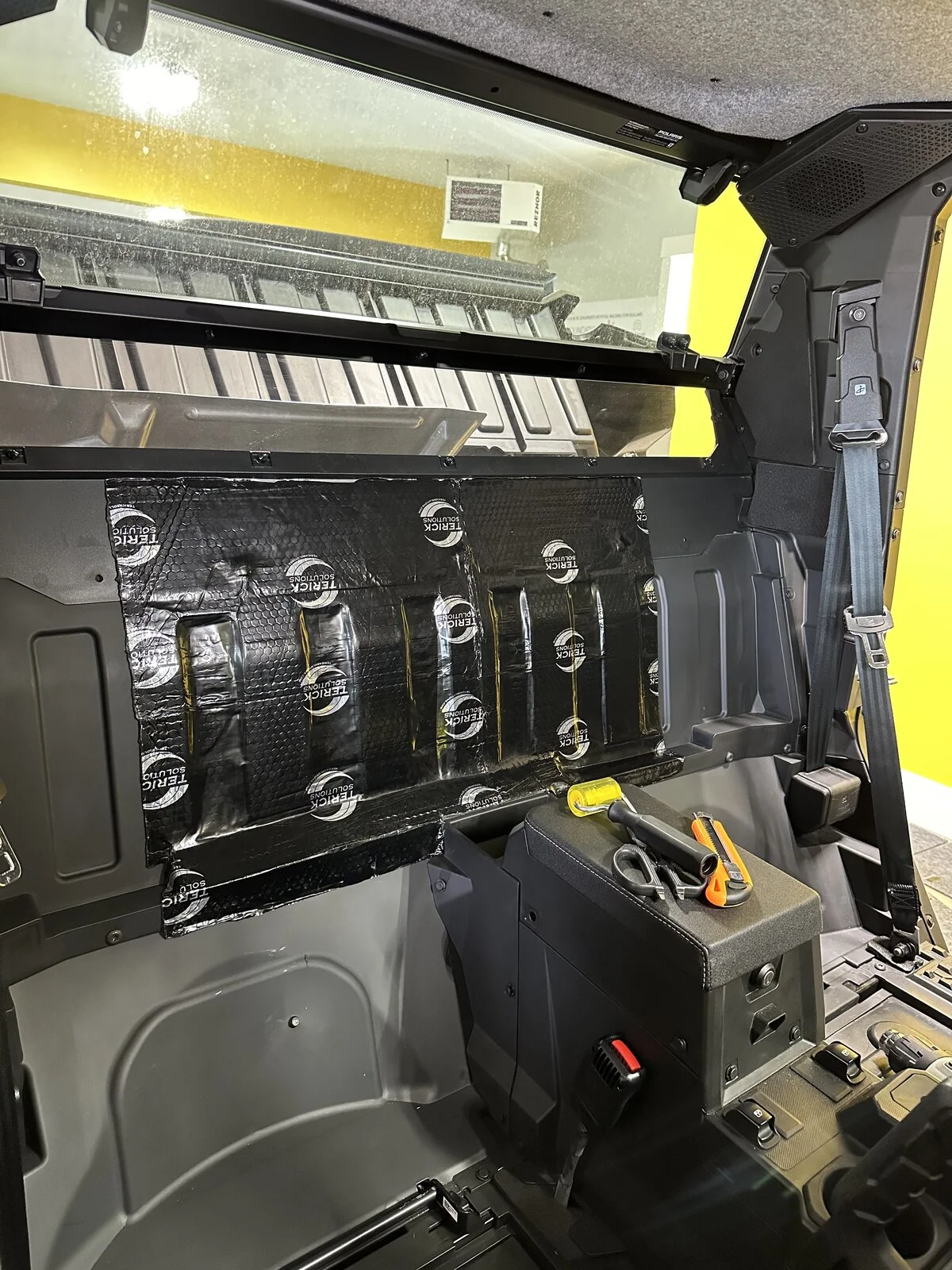

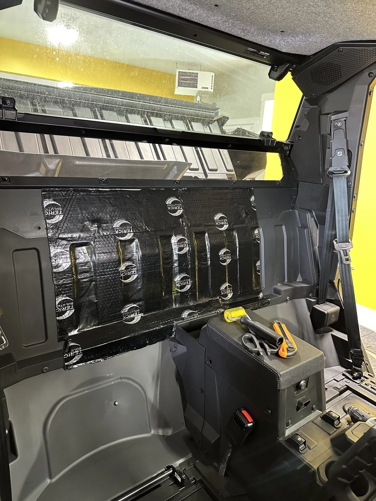

Just started to install the Terick sound damping insulation. So far it’s pretty easy to work with. A heat gun helps make it sticky and easier to work with. I hope this helps bring down the noise levels inside the cab.
Ok I got some time to work more on the sound deadening material, I finished the firewall, floors, and outside rear firewall. Also installed the terick floor mats and carpet kit. The noise level is definitely lower with the sound deadening and quiet clutch kit. I would like it to be quieter so hoping an exhaust company makes a quality product that reduces the sound even more than what’s on the market. It’s a huge improvement but I want more…

I still have three sheets of deadening material left so I might do the doors or the roof, not sure what would be best. Might also get a thick bed mat, any recommendations?
I just trimmed up a piece of 3/4” barn material just like another member did. Fits great and hopefully helps a bit with the noise. Use brand new blades when trimming helps tremendously!
