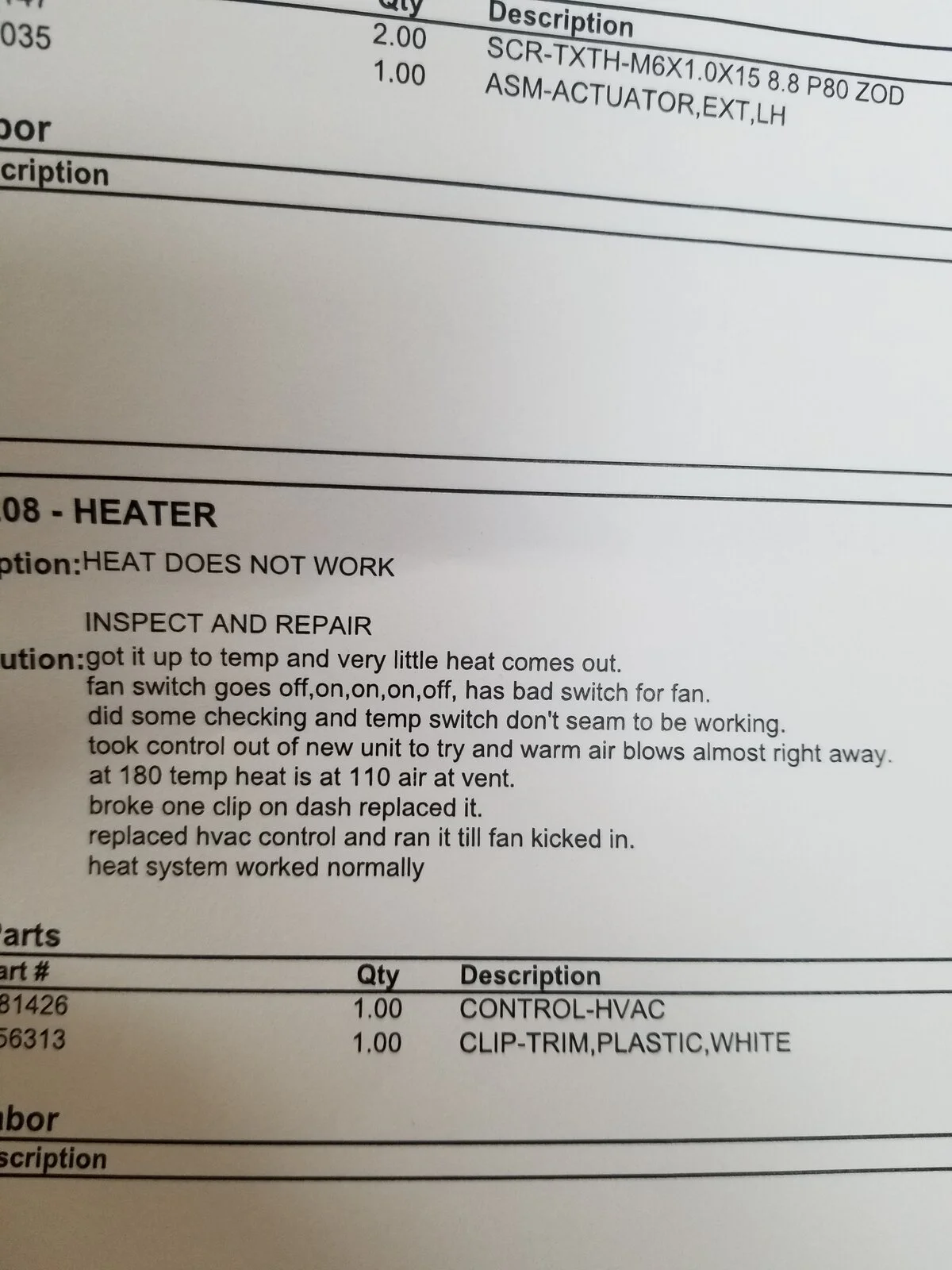

Just got the call from the dealer. Found that the hvac control was bad and the motor on the blend door is bad. Both getting replaced. hope that improves mine
Hope that helps yours but frustrating to me. Were you not getting any temp change from your controls prior to this?
I didn't ever attempt to change the temperature per say, I didn't get mine till it was pretty cold so it was on max heat all the time. The fan speed would go past the max setting & shut off if you weren't paying attention. It seemed the blend door was working, so I dunno. I just got there voice message. If he says anything else I'll let you know when I call him back later

I'm in northern Wisconsin as well and it was terrible. Its sitting at the dealer right now getting a new control panel. We'll see if it helps, I hope so. Will post more info when I get it back

Took it out today. It was single digits over night with ride temp of 16. Didnt notice any change with them changing the heater control. On high with engine temp at 180 it's pretty dismal heat coming out. Pretty disappointed. My 23 ranger had awesome heat
