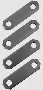

To raise the seat belt because of the seat risers I used trailer shackle links I had laying around. The seat belt bolt is a pain to get to but do able
