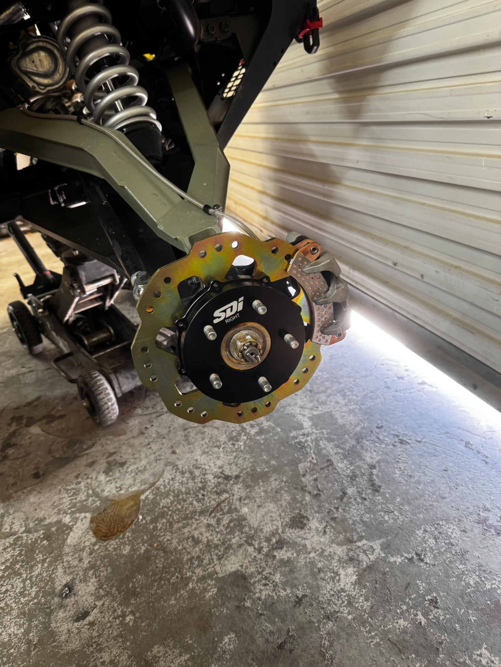

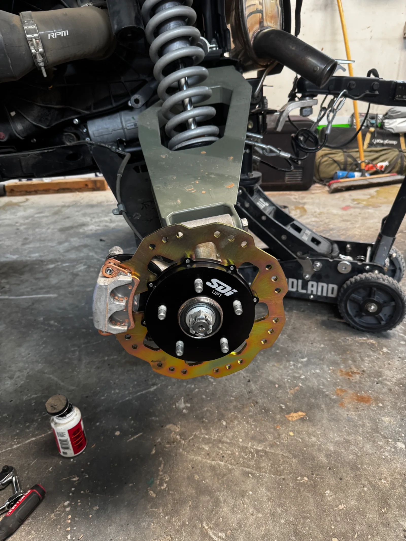

Finally got hold of the SDI Big Brake Kit and got it installed.

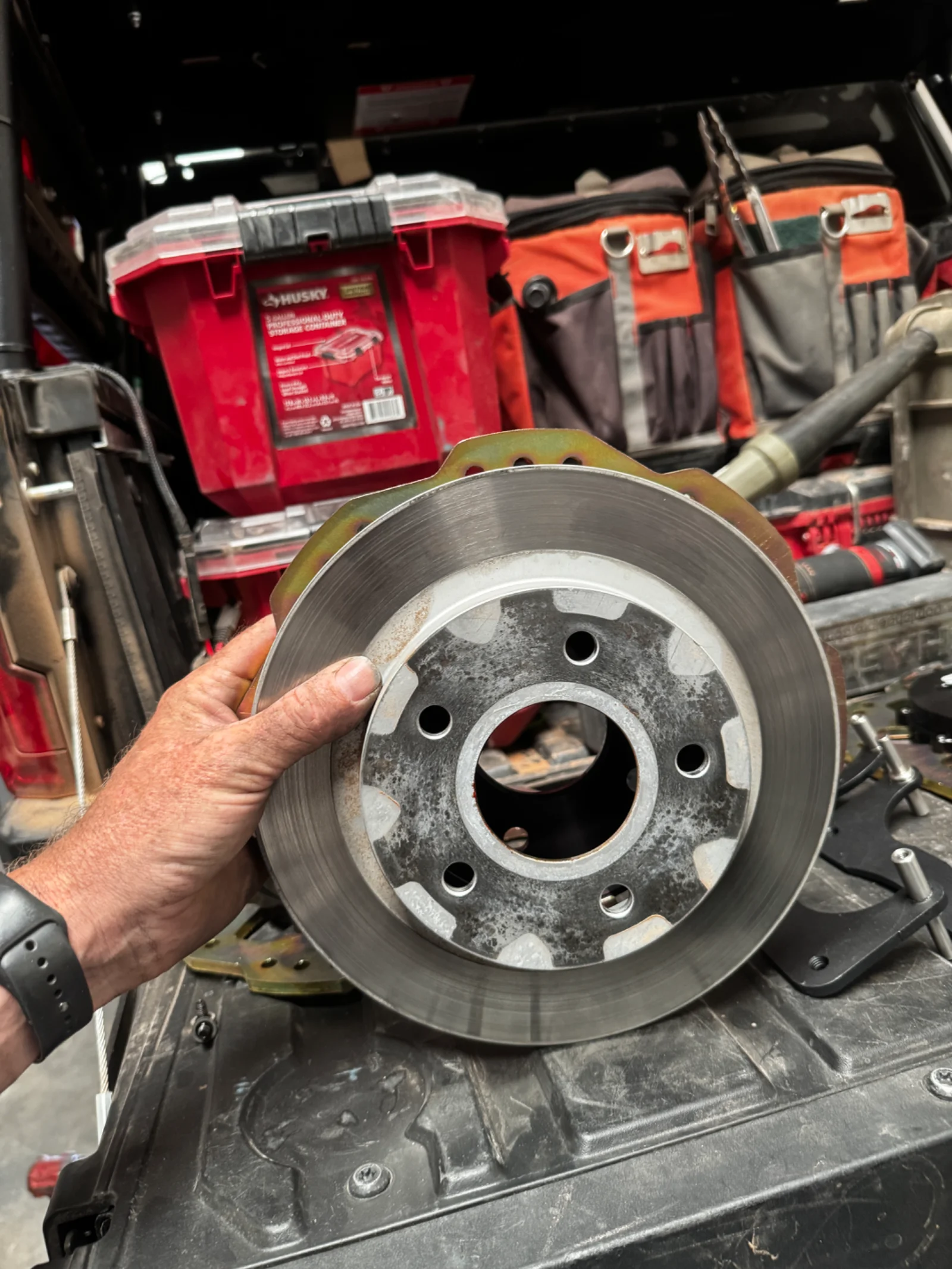

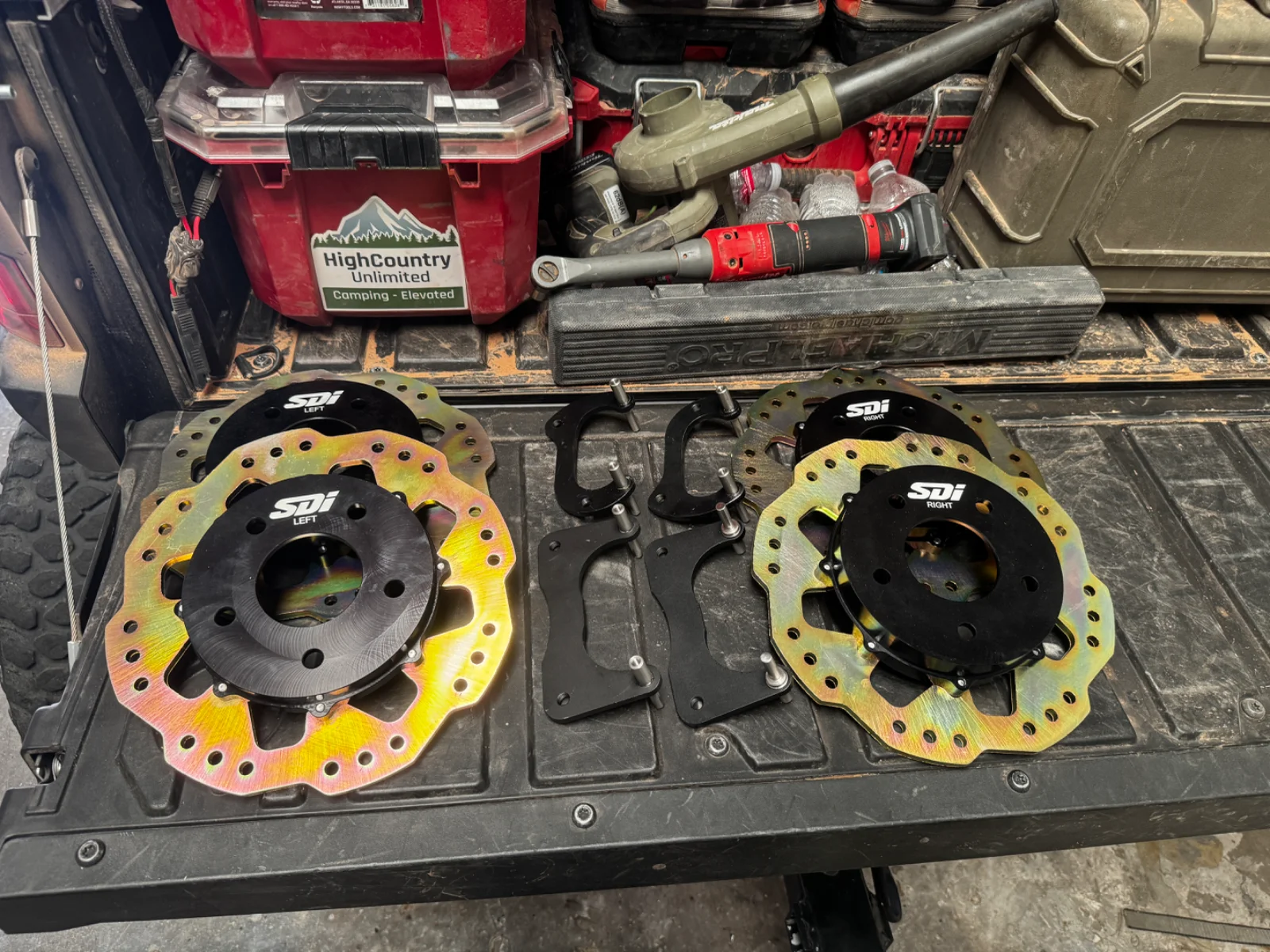

Unlike the TPR kit, this one is just replacement rotors and caliper brackets. Installation is the same process as simply changing brake pads.
The SDI Rotors are a 2 piece setup and around 20mm larger than the OEM rotors. They’re vented, so not good for mudding applications. The new brackets also don’t allow for the OEM rotor scrapers.
So far there’s a definite improvement in braking, but we still need more tome on them to get a true feel for them, as new brake pads and rotors will obviously perform better than worn ones. We went with Polaris brake pads, but SDI recommends Super ATV Sintered pads and said they are more “grippy”.
