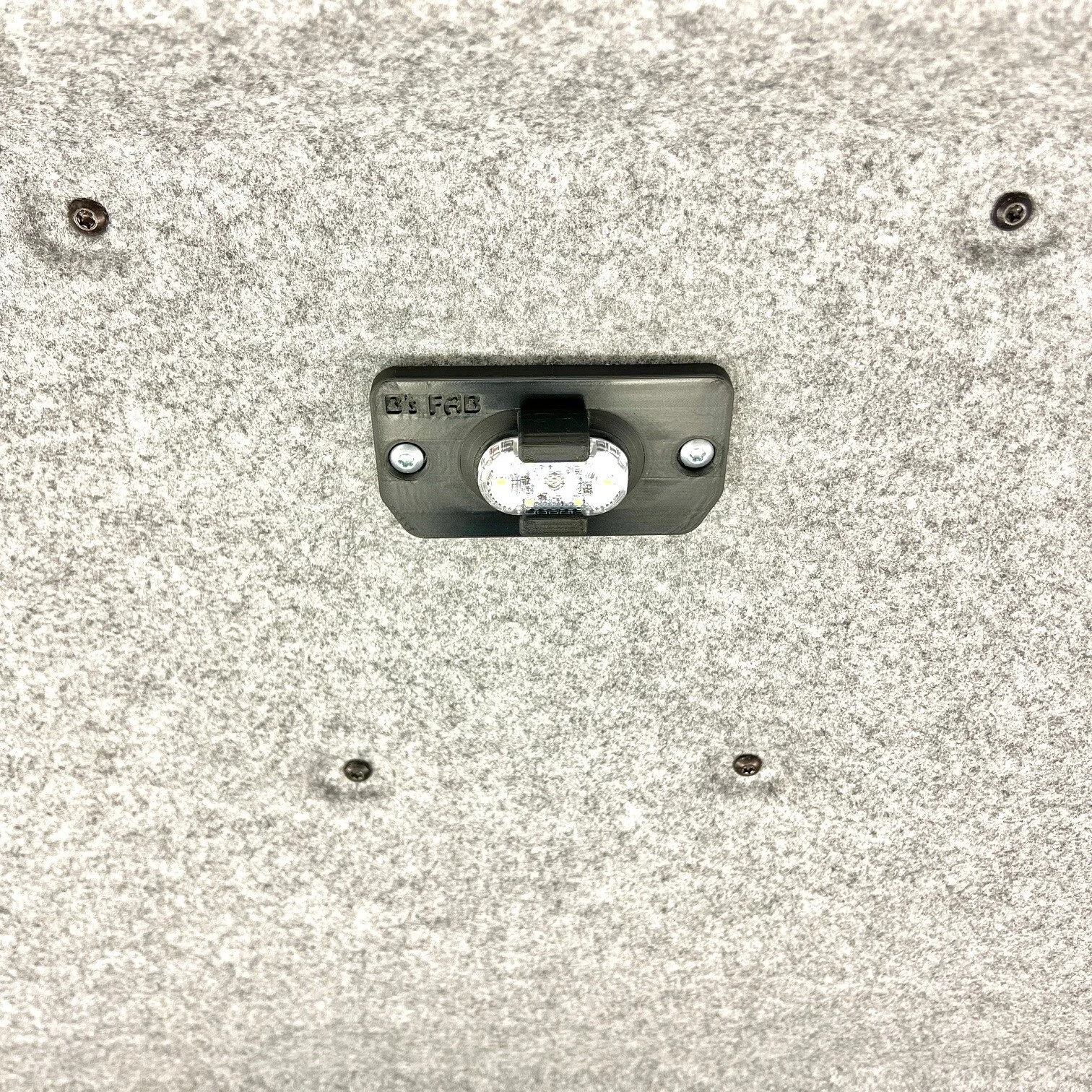

I just installed one of these.
How bright is it? I seen that I just don't think it is going to be bright enough.
Its plenty bright to light up the area at night. Here's a pic with just my backset light turned on.
Thank you for your reply with photo. Yeah that looks pretty bright. I mainly want it to look at my milwaukee pack out boxes in the cargo bay area.
