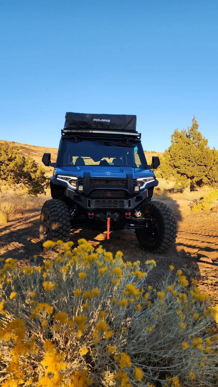

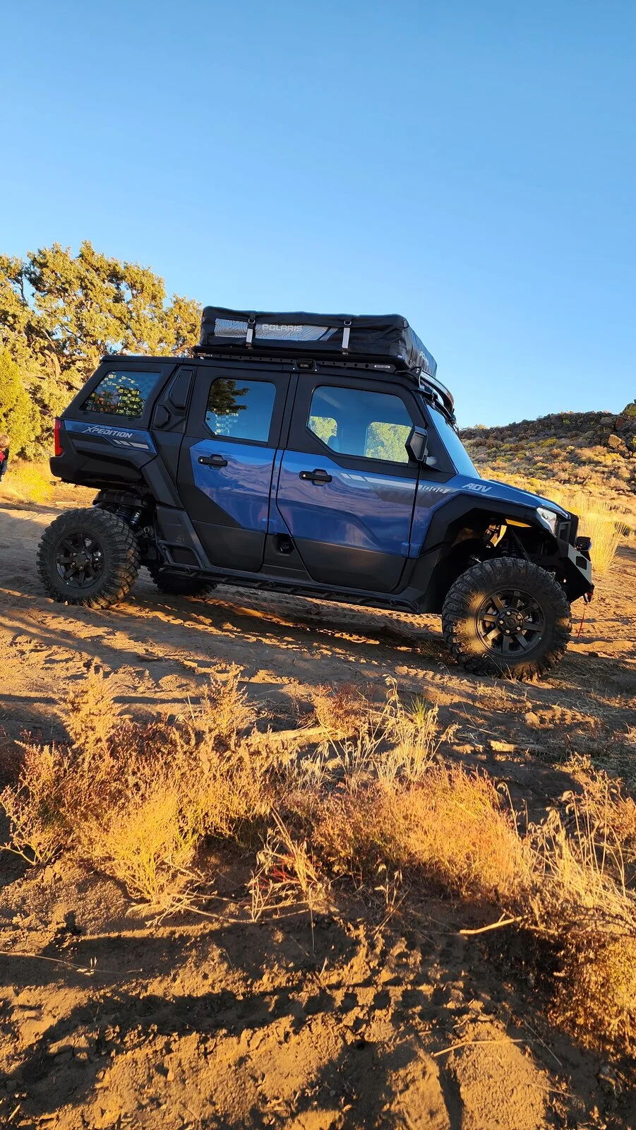

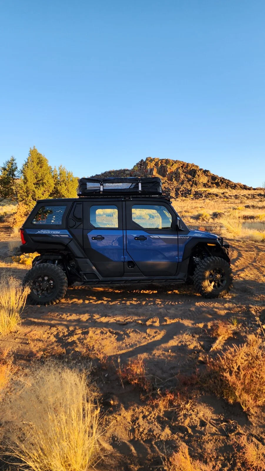

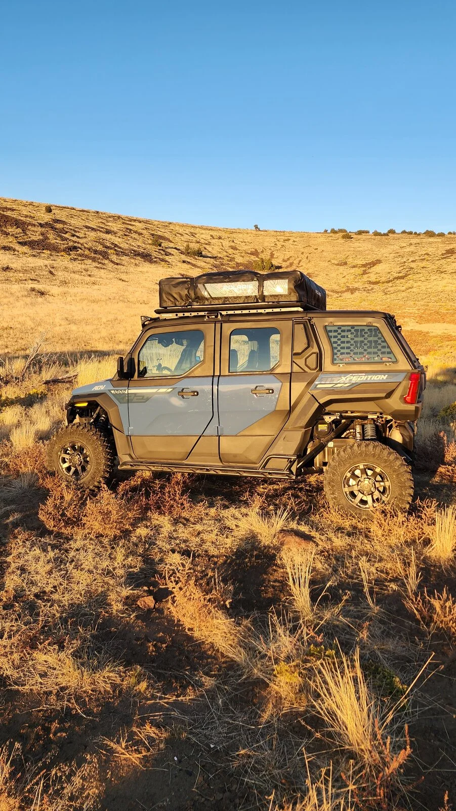

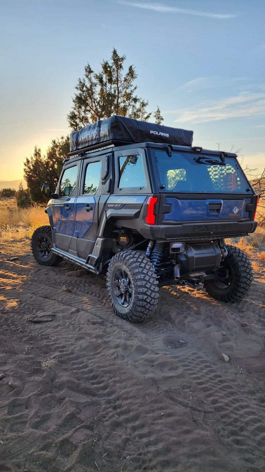

Looks awesome. First one I’ve seen anywhere with the tent on besides dealers.....but got her out into her habitat some more....View attachment 869View attachment 870View attachment 871View attachment 872View attachment 873
Here ya go:It looks great! Do you have a list of all the modifications you've done?
Ha! Thanks for the compliment on her looks! You have no idea how ready I am for that picture too! Gonna be a couple weeks. Have a non-UTV trip this weekend, hunt the next, and maybe after that!She has that “stop lookin at me attitude” I wanna get goin down the trail. Great looking ride. I’m ready for the pick with the tent set up at camp site. Chairs, Fireside whiskey in hand ..

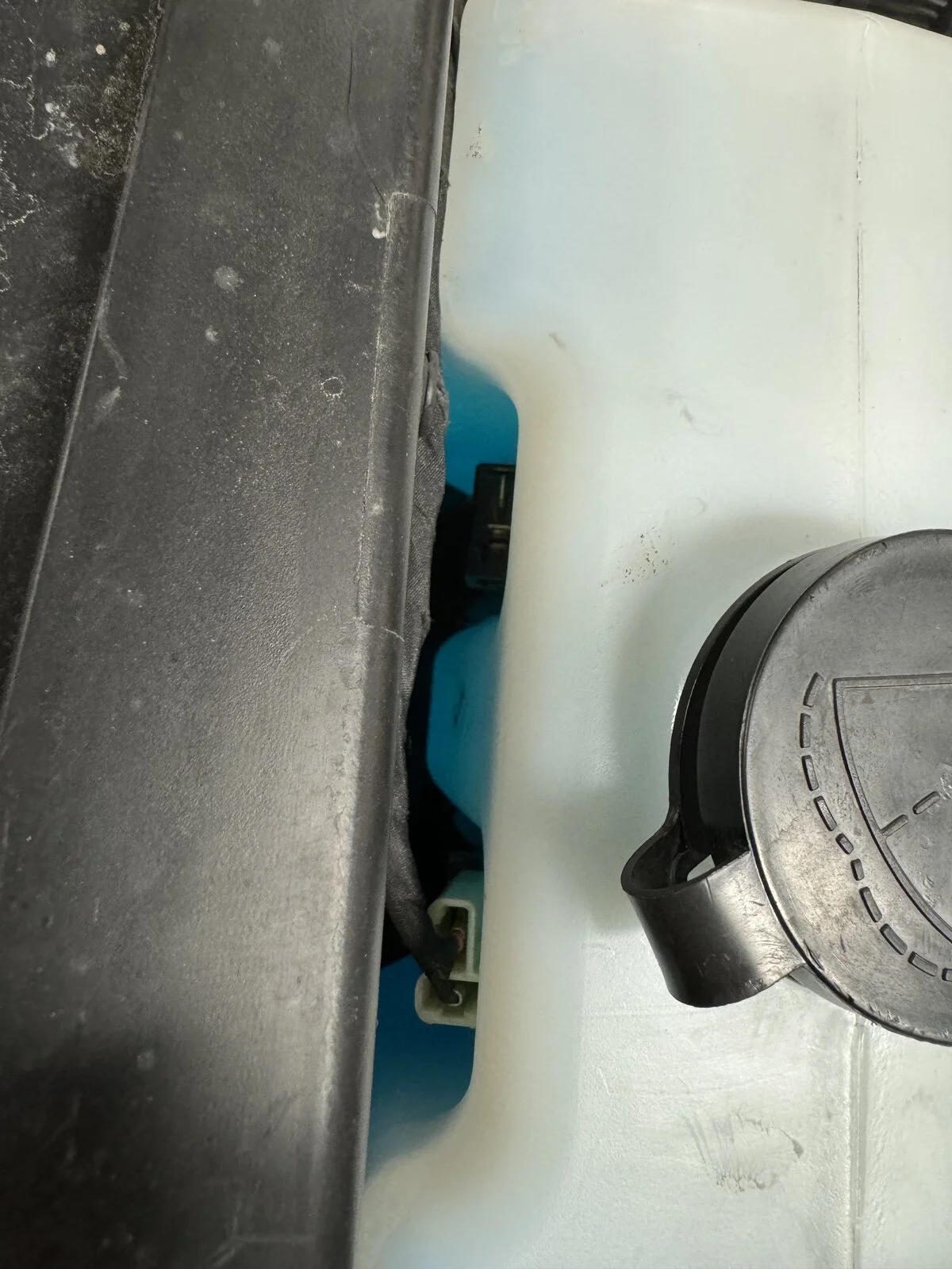

Can you provide further detail of wiring the rear washer pump into the new switch? I have the extra pump, wiring pigtail and the the CRV nozzle mentioned above.I bought another Polaris washer pump that comes with the gasket, I drilled the washer bottle and fitted the new pump in the new hole. I ran a washer line alongside the wires for the rear wiper. Then I used a washer nozzle for a Honda CR-V rear washer. I bought a new front wiper switch and swapped faces so it shows it being the rear wiper. Pinned a wire into the empty slot for the washer and wired the washer that way. Works awesome. View attachment 2138
