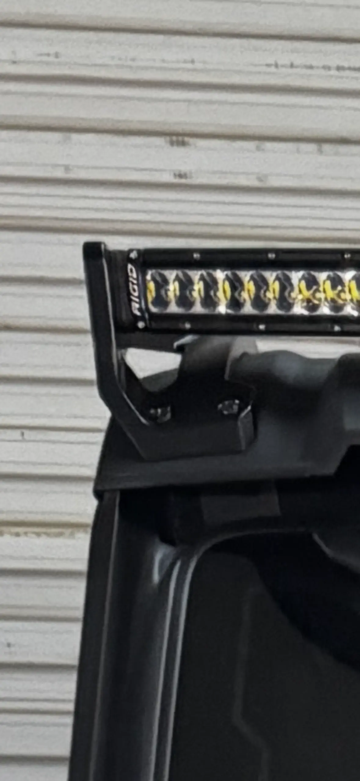

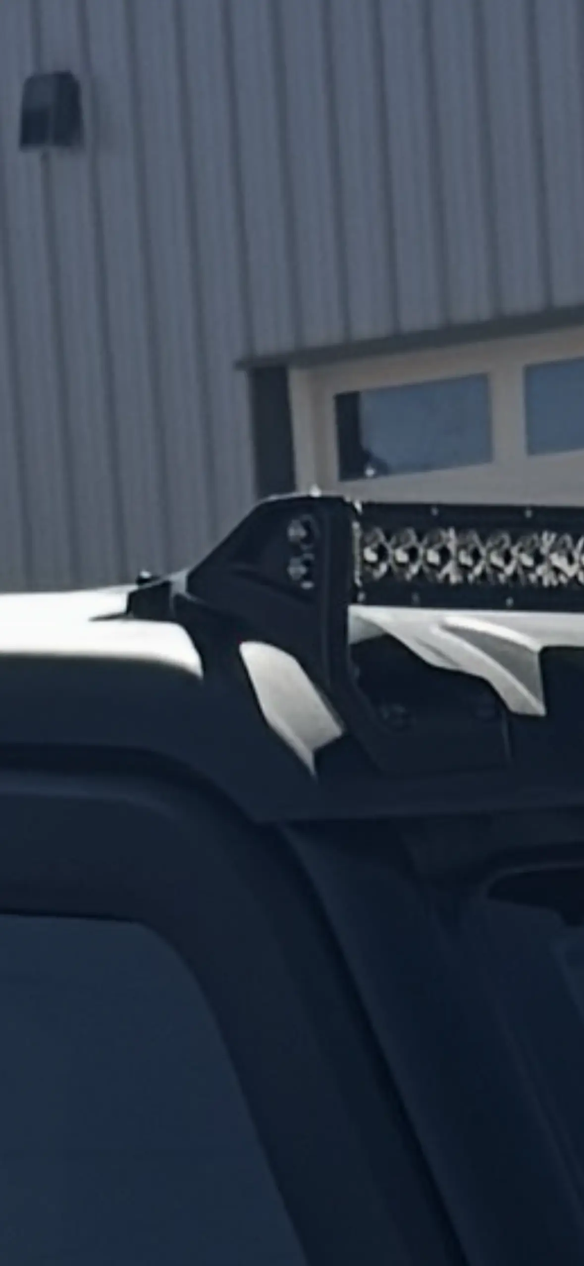

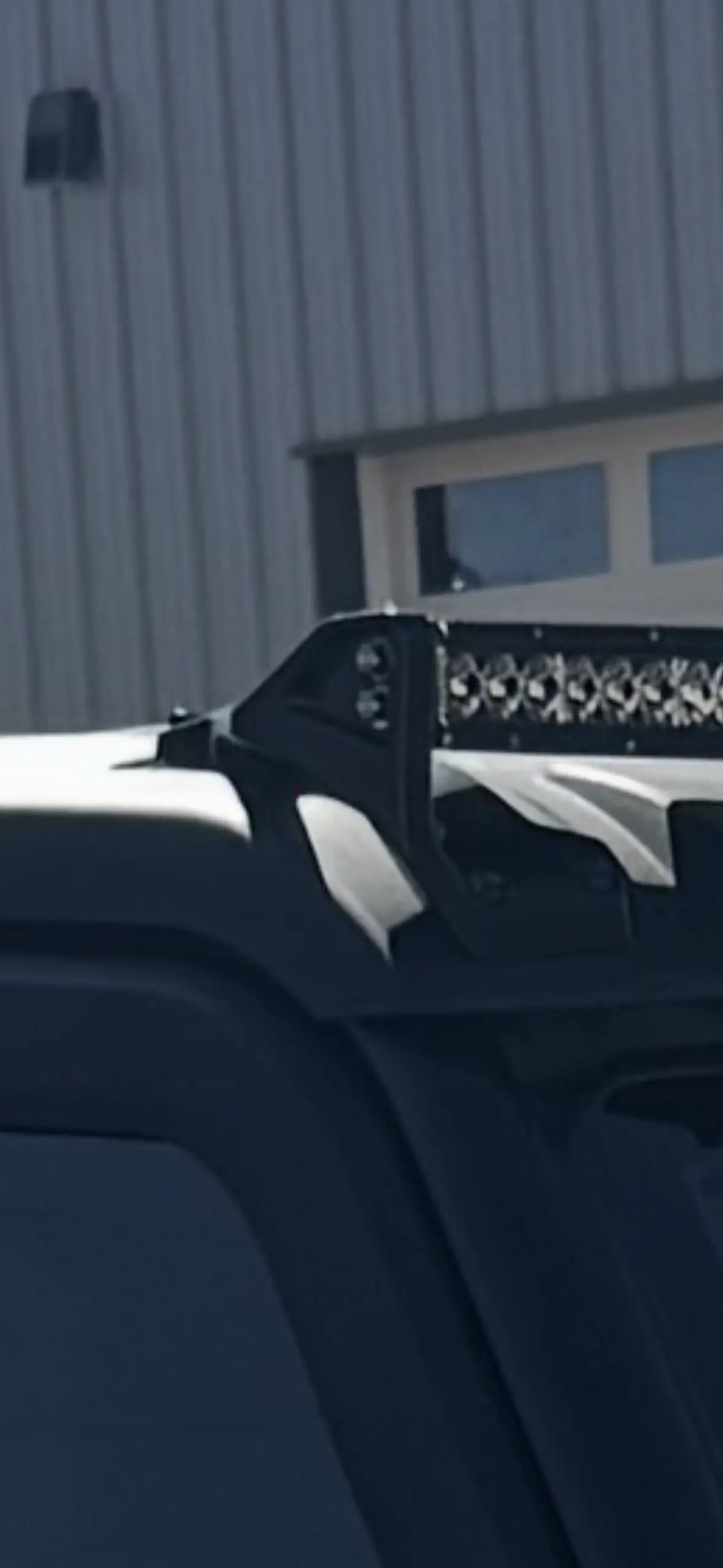

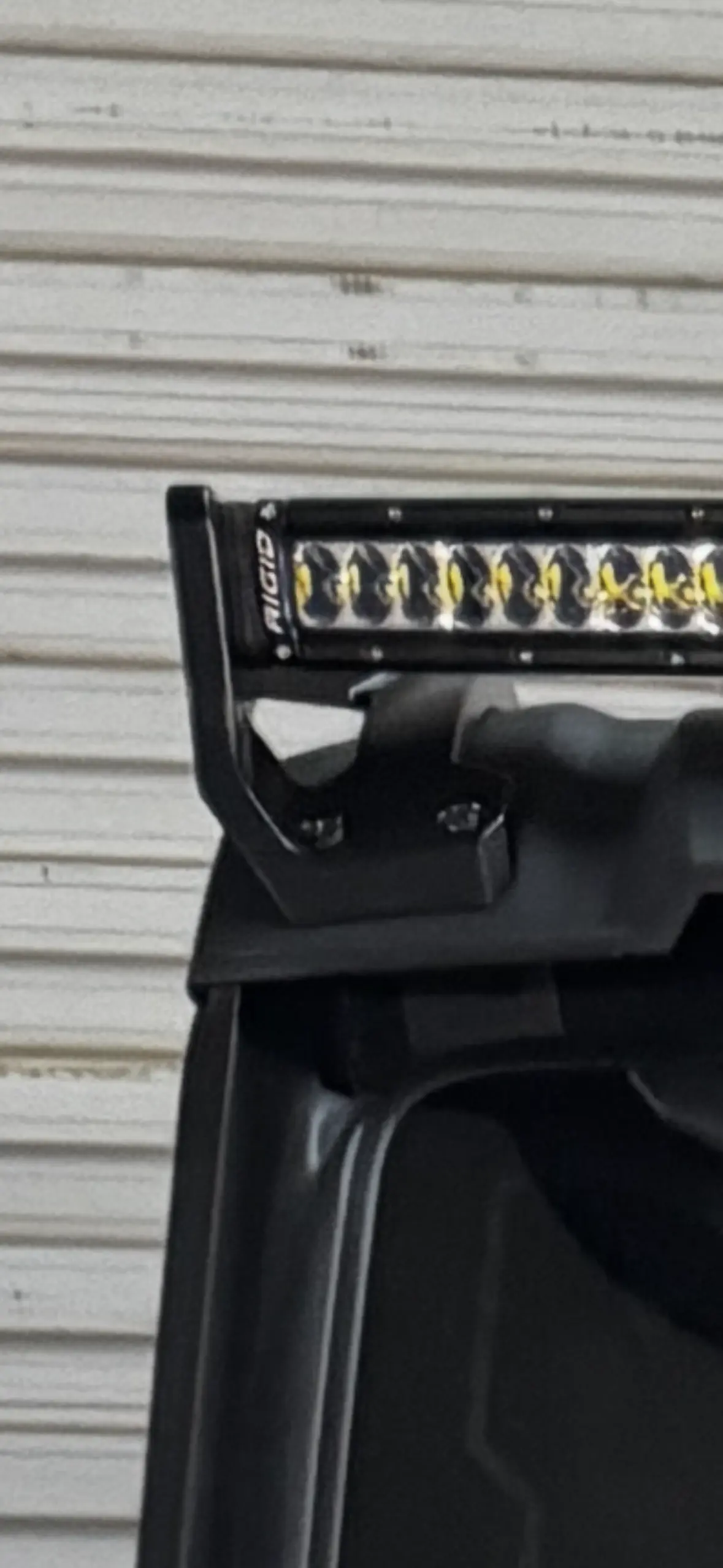

I spent a little while searching and haven’t found anything for the 50” light bars. Because they come right to the edge of the roof, there’s some curvature to deal with.
You might try contacting one of the aftermarket accessories companies like DRT or AJK Offroad and see if they might be interested in making some. Seems like there’s a market for them on the Xpeditions, and it wouldn’t be difficult for them to copy the Polaris brackets.

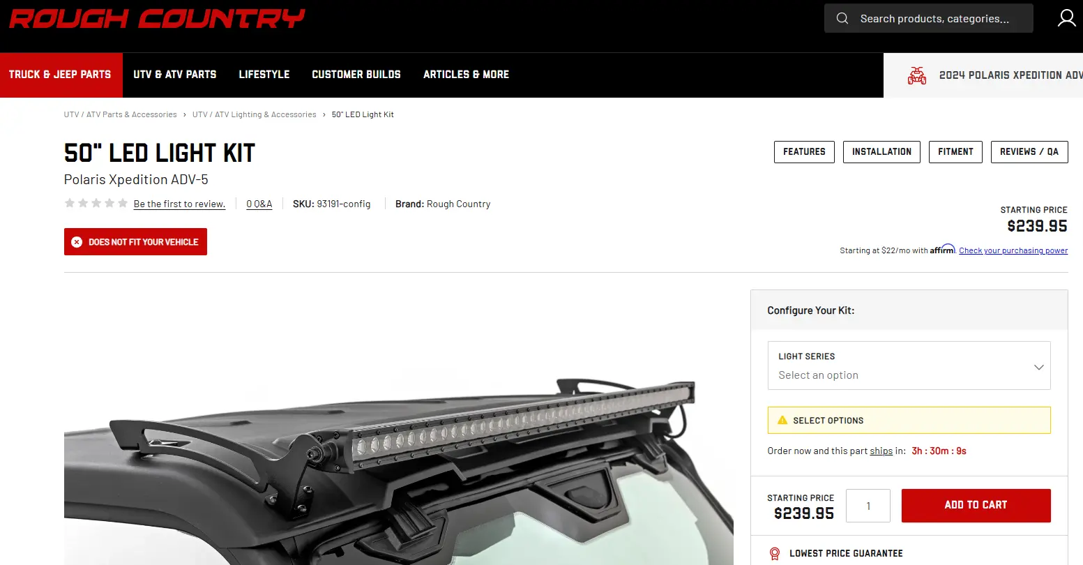

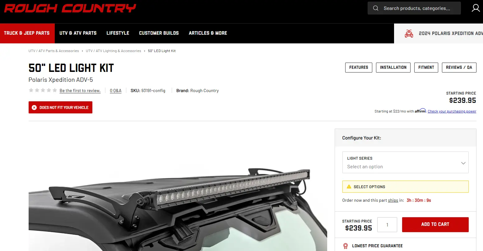

Call Rough Country and ask for the mounts, you can order them separate $ 26
Glad that someone else is manufacturing these mounts, but I don’t like the light bar being forward from the lip of the roof. It allows glare from the light bar to shine down on the windshield and when it gets dusty, it makes it difficult to see. These would be a great option if they moved the light bar mounting holes back just a little.
