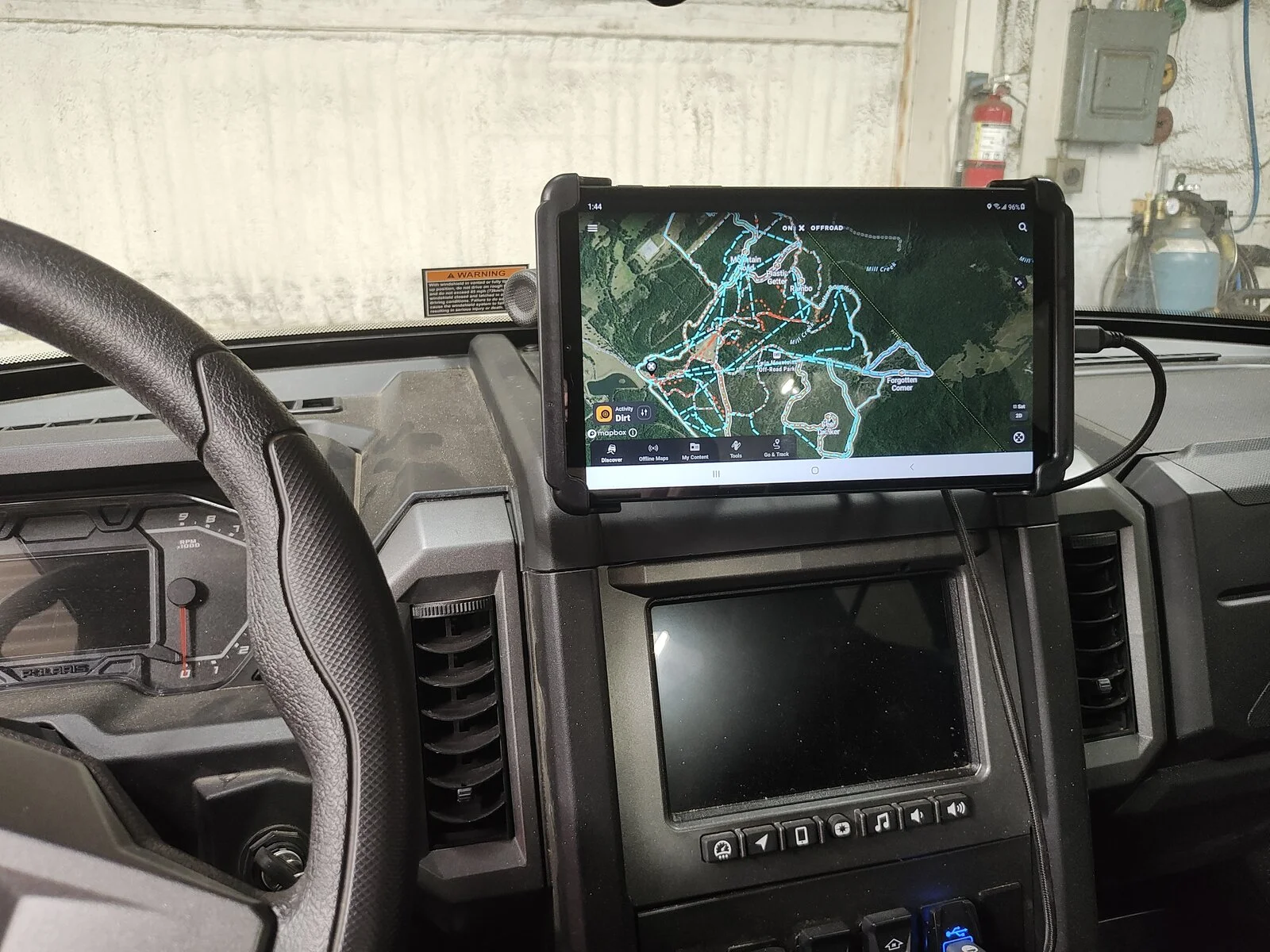

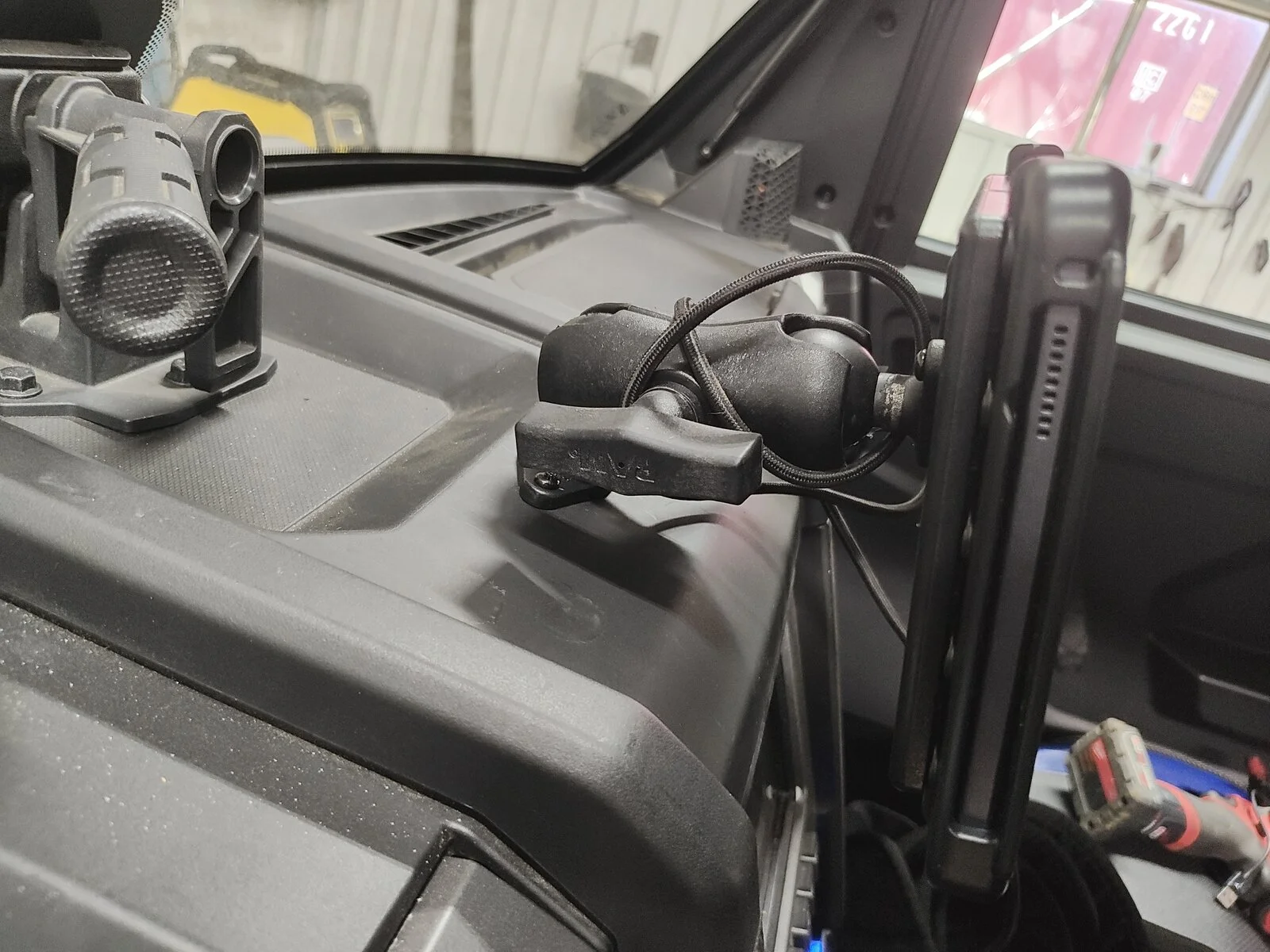

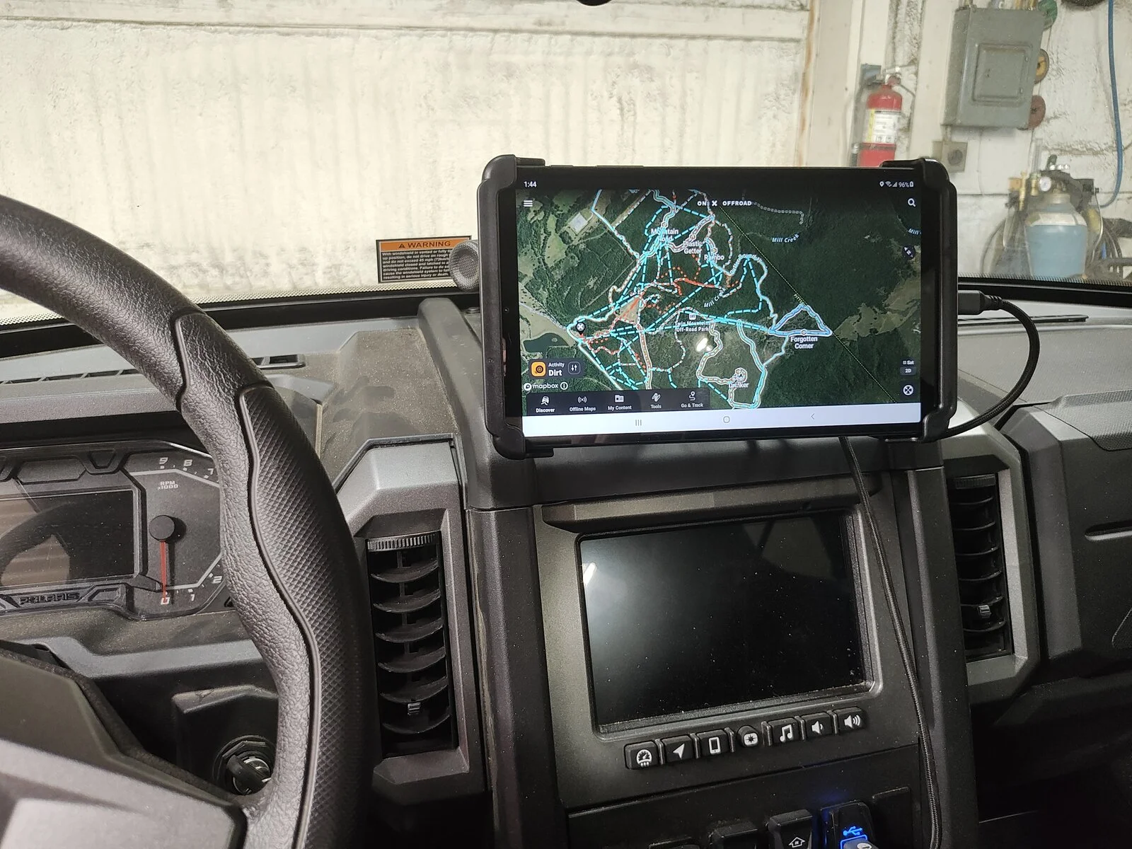

Easy tablet mount for 8" tablet. RAM HOL-TAB24U tablet holder, two 1.5" ball bases C size X002D09UHF and a RAM Mount Plastic 1.5'' Ball 2.25'' Double Socket Short Size Arm RAP-201U-B. Remove the window latch and two push pins. Drill hole and mount the base. Reinstall. DONE!

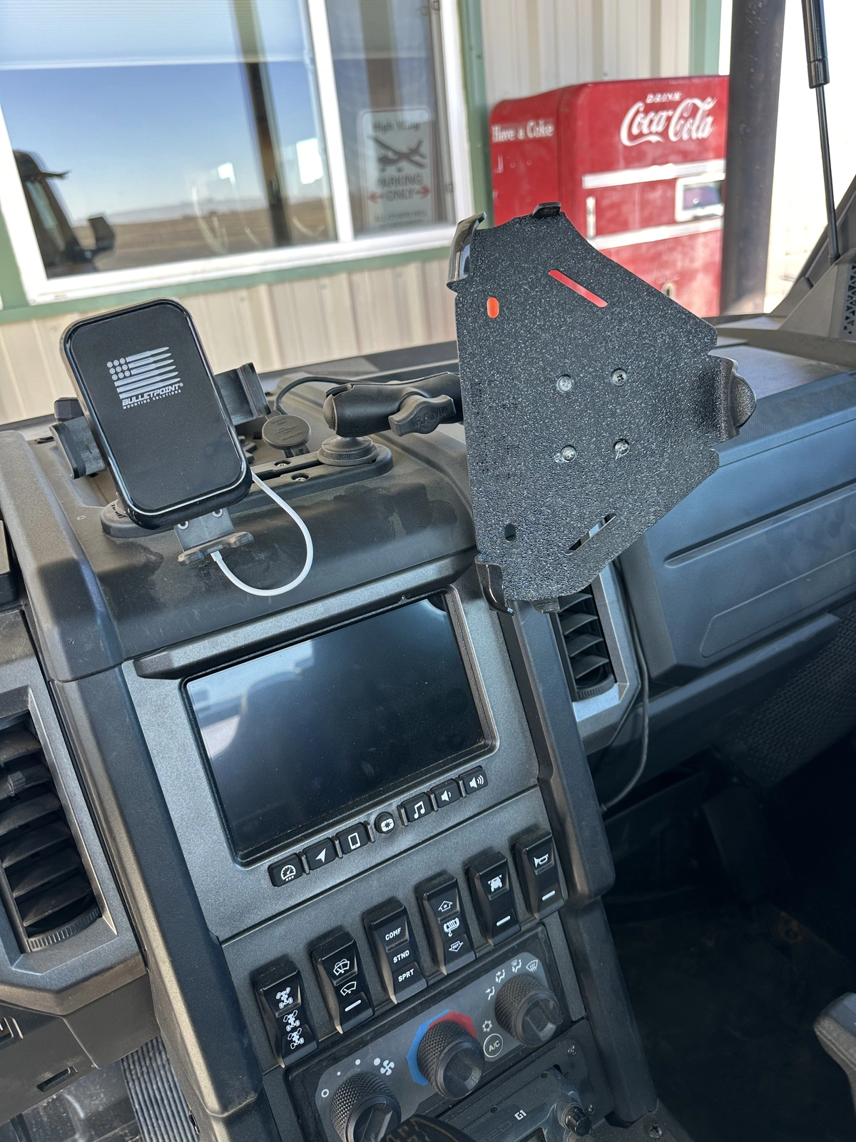

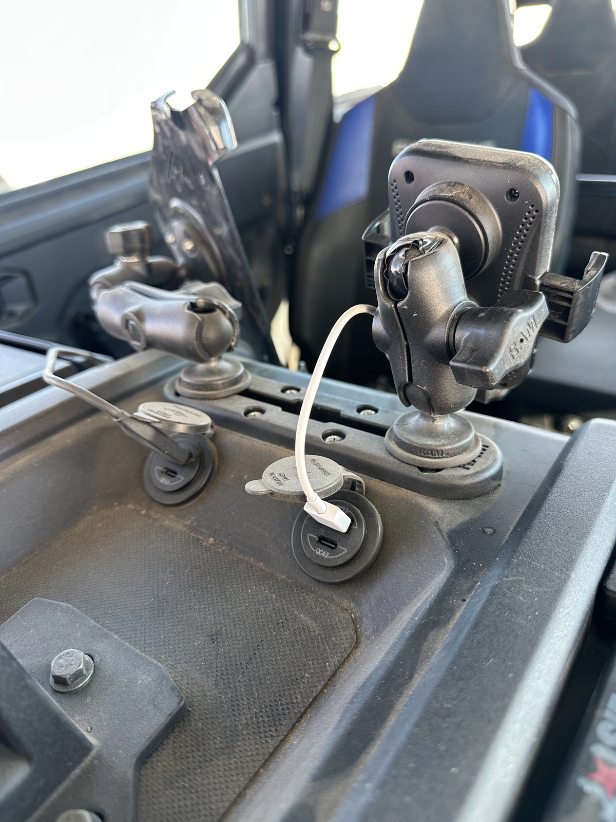

I just finished installing mine. I put the bulletpoint mounts on it. Works great. I have 2 cellphones and a 2way radio mount on mine. I also installed a power source with usb type c. I also purchased 2 short power cords to keep it as clean as possible. I can grab some pics and share if anyone is interested.

Would love to see the pics.

Pictures?

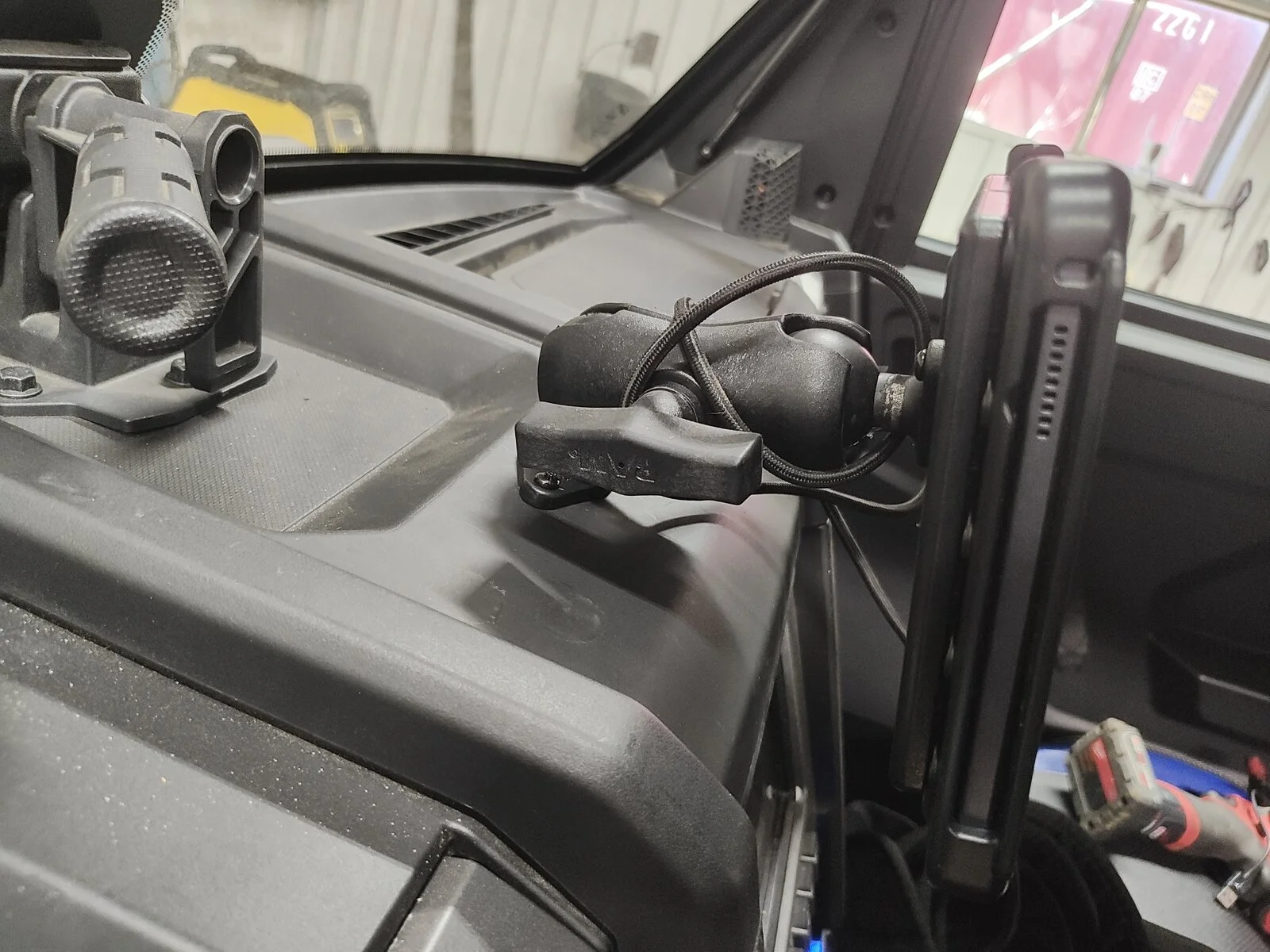

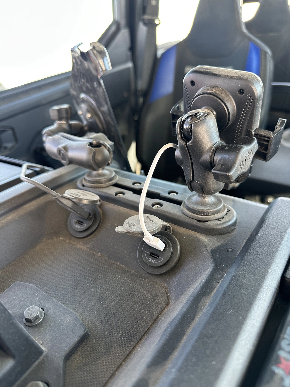

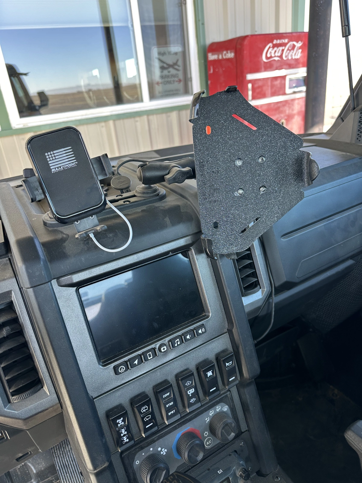

Thank you for the tip! I installed the JK flare and two Ram ball mounts, tablet and phone Rm X-mounts.
Works awesome and seamless installation. Quick and easy. Works awesome with Avenza on the tablet and ride command on the factory map.

What bolts did you use or did you use crews to mount ball ? TIA
