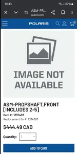

Not sure if this is the problem but on FB, there is a guy who just had a replaced on warranty and it got rid of his front end noise. Looks to be a little heavier but shorter than the first one that came with factory build. The first photo says, "Image not available" but it is part of a bigger photo, so click on it for the part number. The guy is Canadian, so that is why it is priced in CAD.
Ya I think the post you found is for the driveshaft rattle which is different than what we are chasing here. I had that issue too and went to an aftermarket driveshaft to address it.
