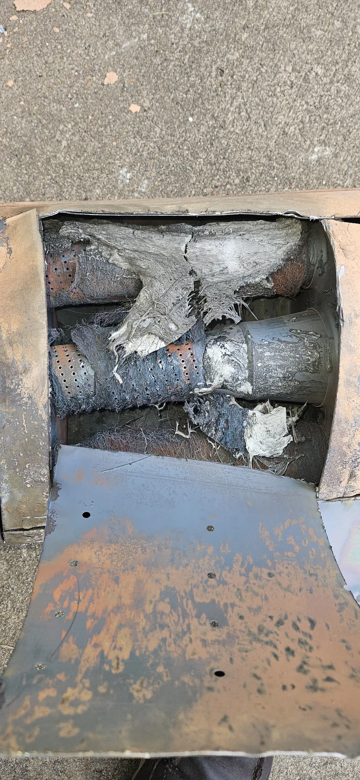

So my muffler caught fire tonight.Glowing red after hitting it with the fire extinguisher. Engine temp normal,no codes,but I did lose rpm's and power right before. Plugged exhaust?

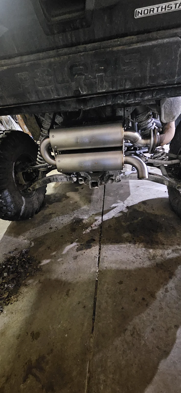

It was plugged.My buddy had a Trinity exhaust at his shop so I put that on. Running normal. I did find a post on FB from a year ago of someone with the exact same issue. He cut the stock muffler apart and found the packing had fell apart and plugged it.
