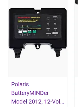

I have a 24 also with original battery, I keep a smart trickle charger on it when not in use. No issues so far.
This is what I use never had a problem.
